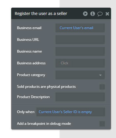

@btinc Can you show me the Step 1 (Register the user as a seller) part.
Also, do you have both test and live keys in the correct fields for the Bubble Plugin page?
Here it is. Yes I have the live and test apis in the correct fields, also the Live Client ID
