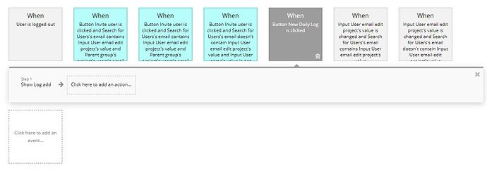

In the workflow: When the button was clicked, show element.
In the conditions of the button: When the current user’s email is something the element is visible.
Please help me.
Thanks in advance!
here is the workflow

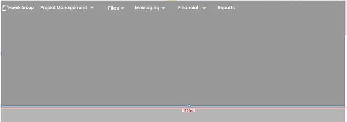

When you go in your page in debug_mode and do step by step, does it trigger something? It may help you find some more info. Also, click on inspect, and move your mouse hover the button and try to click it. Does it select the button or something else?
I think I know what is the problem. When I inspect the button and it doesn’t pick t up but it does pick the header so I think the header is I don’t know how but it is above the button and it is not picking up the click.
Yes. this is the issue. The header is above your button.
If you edit your header, you can see that height is very important. So you will need to reduce it.
I think the blank space is the problem. It may be above the button but it is invisible somehow
You will not be able to drag the bottom because there’s stuff into the page. But you can click on the header and manually reduce theheight of the element.
Yes I am doing it manually. Thank you for your help. You rock!!
