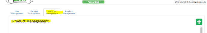

I have a settings page in my application where you can add / remove users, add service packages, add-on’s and products. but i need to add tabs. I’ve been messing around with it all morning but haven’t figured it out.
The default element comes with 3 tabs. I’ll need way more

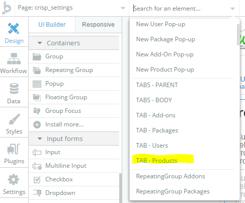

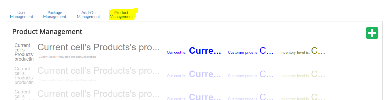

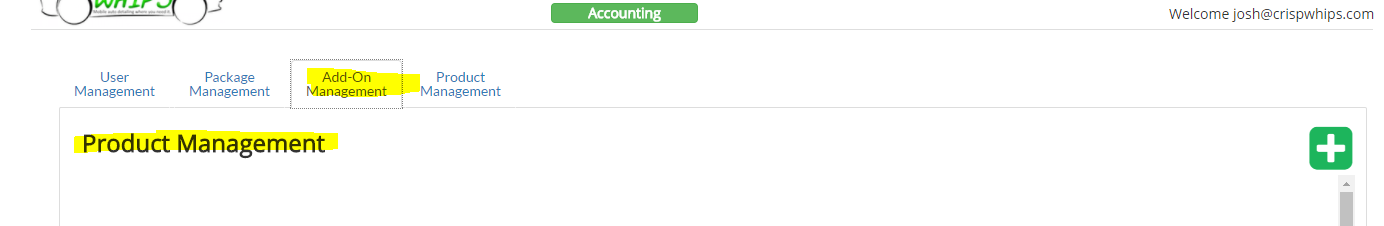

I copied the “Add-On Management Tab” and It’s body… but now the add-on’s tab is trying to display the Products tab… but only displays the title. Then the products tab doesnt display anything…

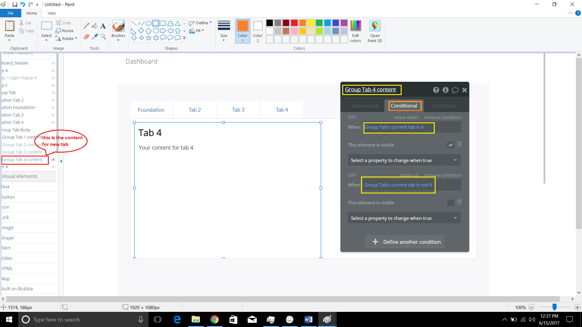

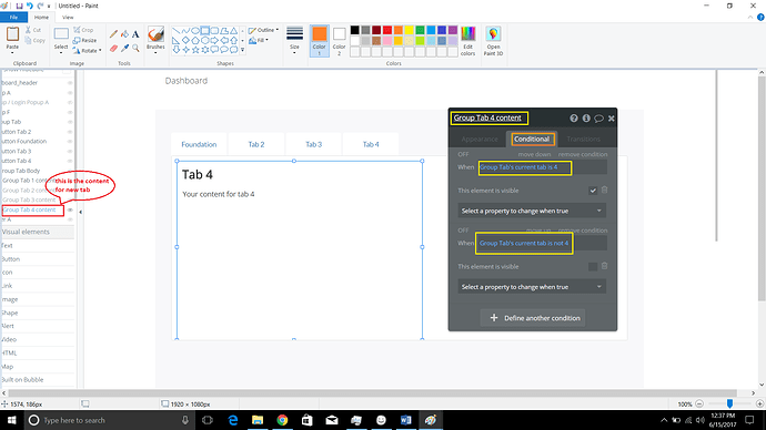

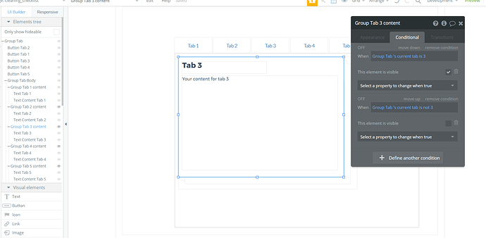

The red marks are the new tab and content components, ORange marks are the tabs under which u need to change content and yellow marks are the content that u need to modify or update.

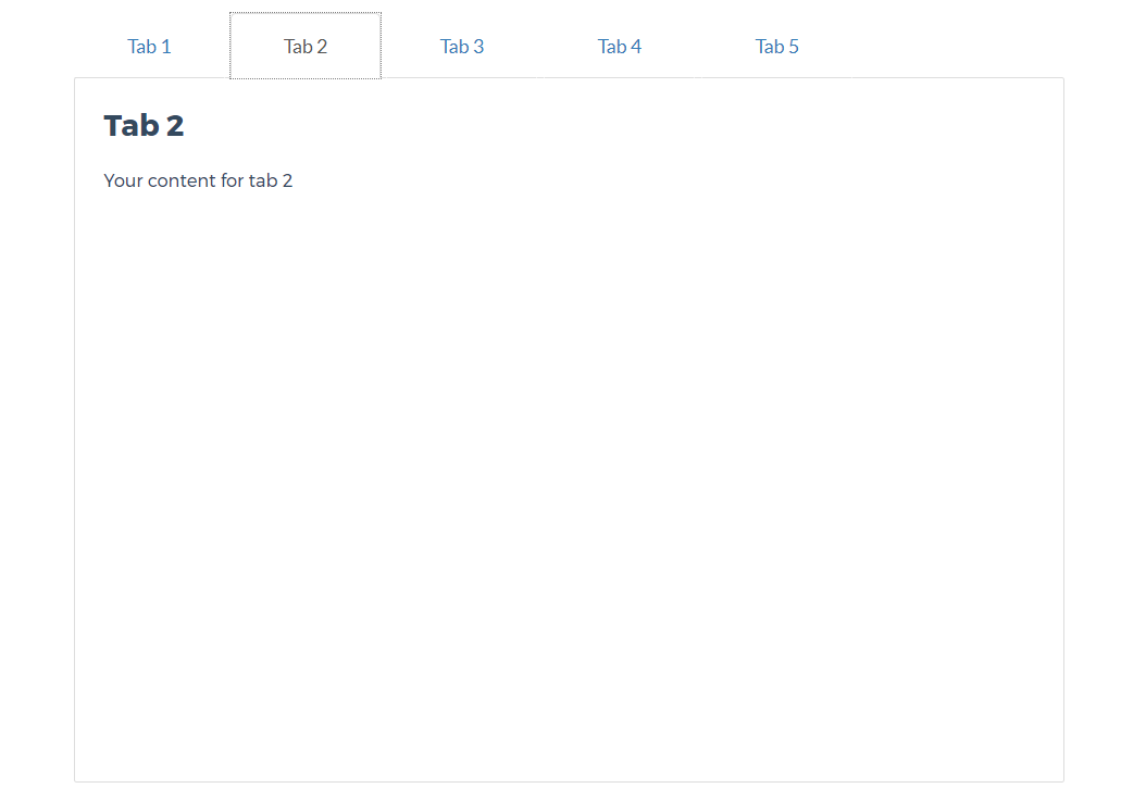

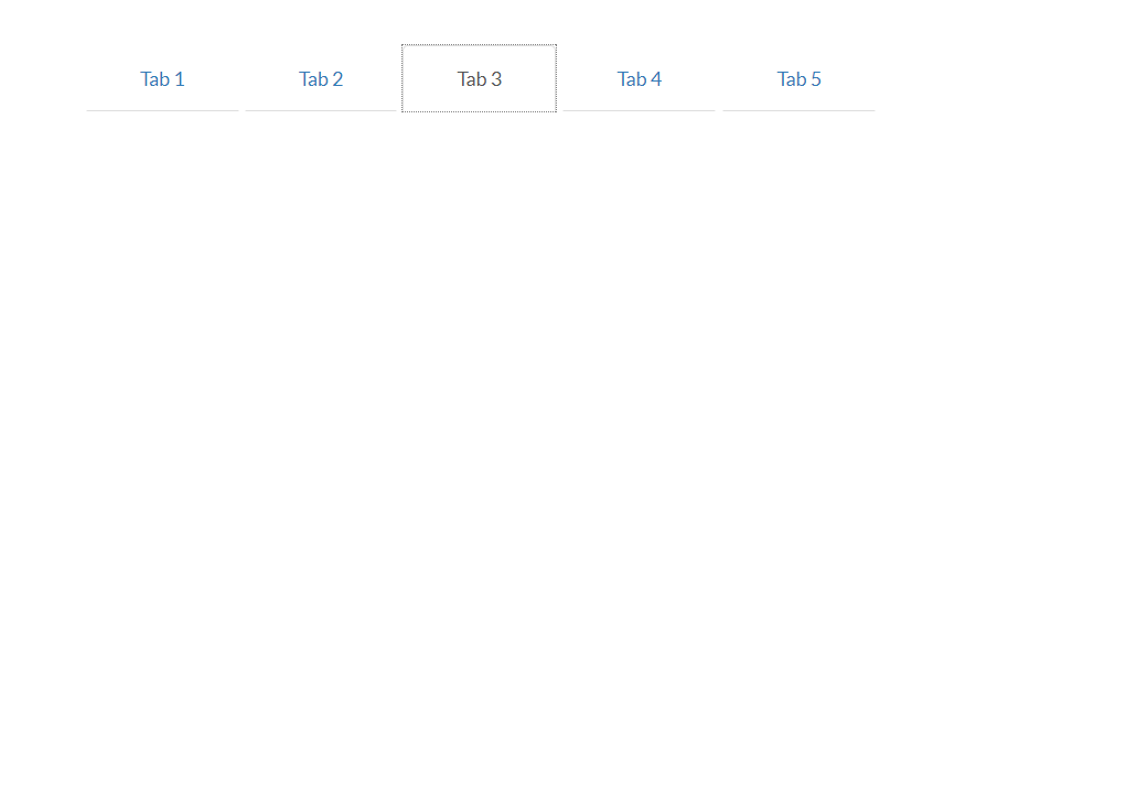

HI Guys, Just went through your conversation step by step and am so frustrated. I’ve done every step about 4x and started over from scratch, but once I add tabs, I can only get one to display. Losing my mind here and would be so grateful for some help! WHAT AM I DOING WRONG?
