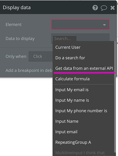

In the workflow, you can call the data from the API
then

For anyone else struggling with this - I found another way of doing this:
E.g. I was trying to set a video’s videoid to only show up after a button click. I did it like this:
  1. Create video item
  2. Create button
  3. Create button workflow
  4. When button is triggered, set a custom state
  5. In the custom state - display dynamic data - In there do your api call
  6. Video options - dynamic data - search for the element’s state in there.
