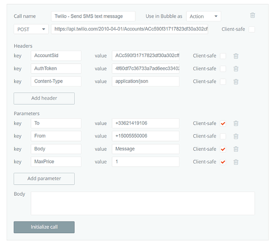

I’m trying to make a simple send message call using twilio and the API connector.
However anything I try I’m getting a no credentials provided error.

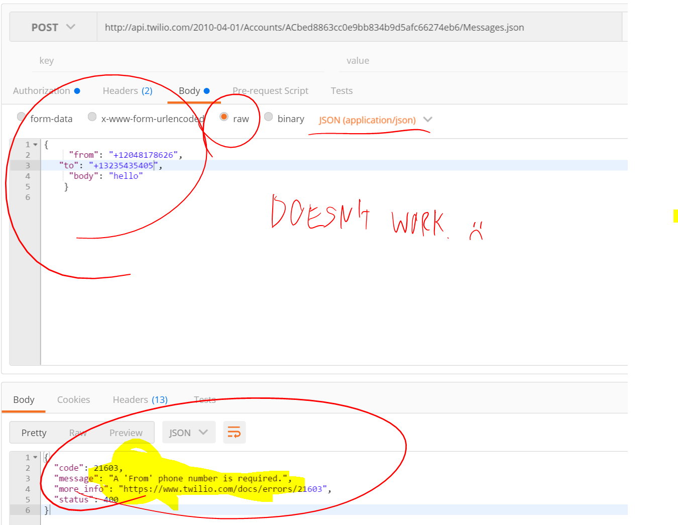

But here is another problem, for some reason it works when my body is “form-data” but it doesn’t when it’s “JSON”
I do add the ‘Content-Type application/json’ to the but still getting an error saying that I must provide a From number, which I do in the JSON.
Any ideas?

About your “missing” number, why do you use the body ? I mean, can’t you set the parameters like I did on my screenshot ?
Because it has to be in the body in order to dynamically change it.
When you use the workflow action → TWILIO → bubble will allow you to set dynamic data to the body
You need this to tell the call what’s the current users ‘To’ phone number and also you can change the message that will be sent by changing the “Body”. You can’t set dynamic data to parameters.

But about this :
You just have to check “client-safe” on the left of these parameters and you’ll be able to change it dynamically in your workflow
I didn’t even realize that! Thanks.
But I’m not sure if you can put that in the header… it doesn’t work for me…
you mean you set the parameters like i did on my first screenshot ?
Yes.
Too bad, I get the same error about the “From” required (in Bubble, and in Postman).
I also tried a magical number like +15005550006 but the error codes stands the issue isn’t here anyway.

So I figured out that Twilio need urlencoded data - you can’t send JSON format to twilio!
It’s very important.
More info on it here: https://twilio.radicalskills.com/projects/getting-started-with-twilio/2.html
So you want to use an encoder like this one: URL Decoder/Encoder
To create a post like this one: From=%2B12048178626&To=%2B13235435405&Body=hello
You also have to make the Content-Type into application/x-www-form-urlencoded
It’ll look like this:
Setting all these I can make it work from POSTMAN

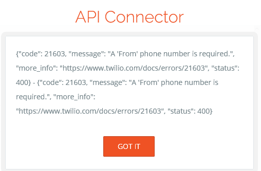

BUT when I put the exact same request into the Bubble API Connector as seen below:
I GET THE SAME EXACT ERROR about the From number not being provided.
So at this point, I have NO IDEA what else I could do…
Hopefully someone can take it from here and figure out what will make this work.
