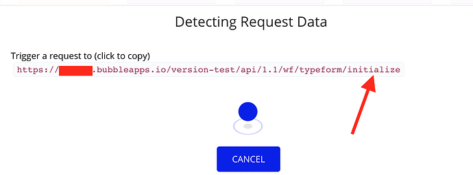

Hi @anthony2
What you trying to accomplish is to use https://developer.typeform.com/webhooks/
Run from Bubble your endpoint with Detect Data. It open the Detecting Request Data window. You see INITIALIZE, you have to remove it later from Typeform webhook.
Create inside Typeform a webhook with your Bubble link. You have to setup INITIALIZE the first time, and remove it from here after.

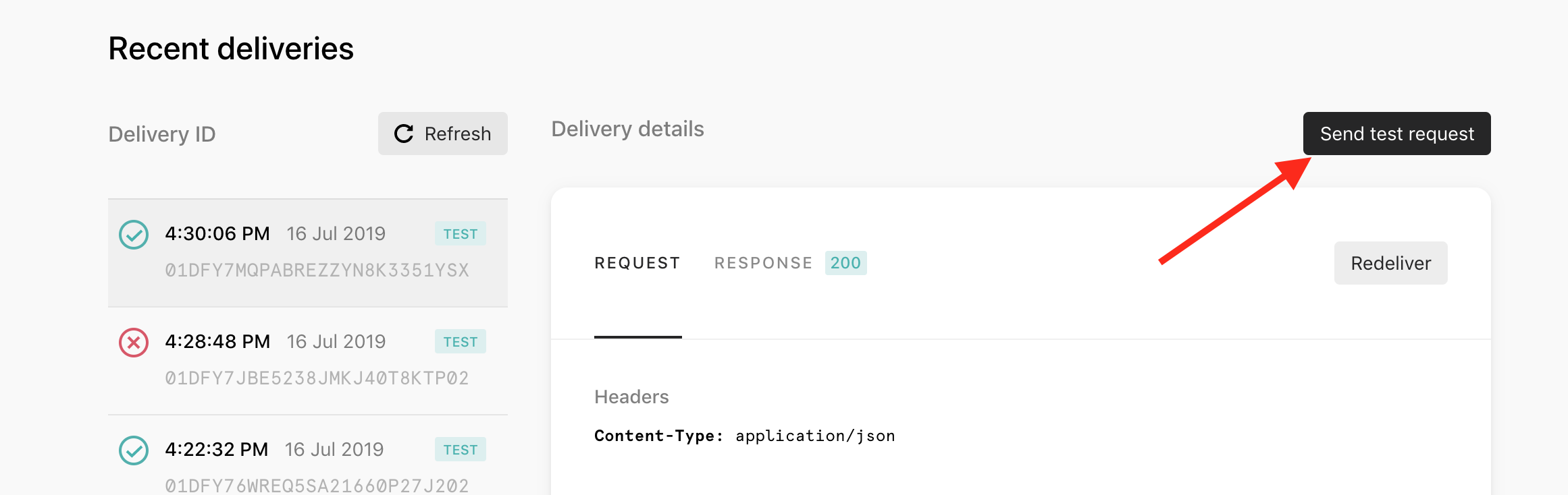

Webhook from Typeform.
Then send request from Typeform (test one), and Bubble window will appeared. Choose the fields you need. Here I took only the essiential to see if it is working.
The test is working.
