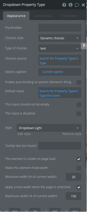

I am able to map all the user inputs to their corresponding field types except for dropdown values. For dropdown values specifically, when I try to set the “Property Type” field = , the dropdown property type is greyed out and doesn’t allow me to set the field value equal to the “Property Type” field. It says ‘Incompatible type’. What am I doing wrong? See below.
Screen Shot 2020-05-23 at 3.04.57 PM

Hi there, @SeanB… the issue is that you have selected text as the Type of choices for your dropdown. You would need to select Property Type in that dropdown. That being said, is the only purpose of the Property Type data type to populate a dropdown with values of Residential, Condo, and Multi-Family? If so, you might want to consider using an option set for those property type options… just a thought.
