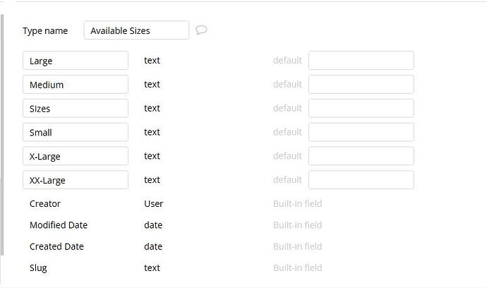

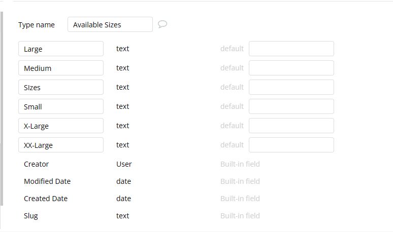

Do you mean like attached screenshot?
I’m not too sure what I’m looking at there… but it doesn’t look right to me.
I would use an option set for colours, and an option set for sizes.
I’d have a product datatype that contains a field for ‘Available colours’ (a list of colours’) and a field for ‘available sizes’ (a list of sizes).
Then have a Product_variant datatype for each product variant (linking each product to each size, and colour etc.), along with variant specific details such as price and stock count etc.

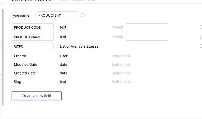

Hi
Is this correct
No.
You need to link it to the Product with a Product field.
And a product variant can only have a single Size (not a list)
And, unless it has a different name than the Product, there is no need for an additional Product Name field (unless you have a specific reason to do so).
Also, I would use an Option Set for the Sizes, as I mentioned previously (not a datatype).
