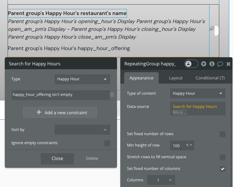

My simple database structure:
Data Type: Restaurant
Data Fields: name (text) and happy_hour (List of Happy Hours)
Data Type: Happy Hour
Data Field: restaurant (Restaurant)

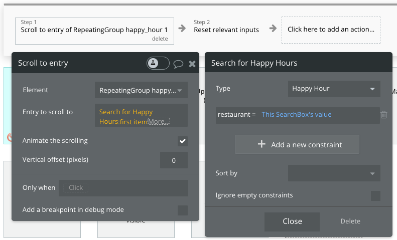

My search box is dynamically searching the “name” data field for the Data Type “Restaurant”
The repeating group’s data type is “Happy_Hour” linked to the Restaurant data type
When the search box’s value is changed, a workflow is triggered that scrolls to the repeating group entry where the search box value = the name of the restaurant.
Is it possible to use a search box with one data type to search and scroll to an entry in a repeating group that has a different data type?
Your approach looks ok to me, not sure why it’s not working. The only thing I would try is to remove the “Reset relevant inputs” after the scrolling. Maybe that’s resetting the SearchBox value before scrolling is finished :man_shrugging:

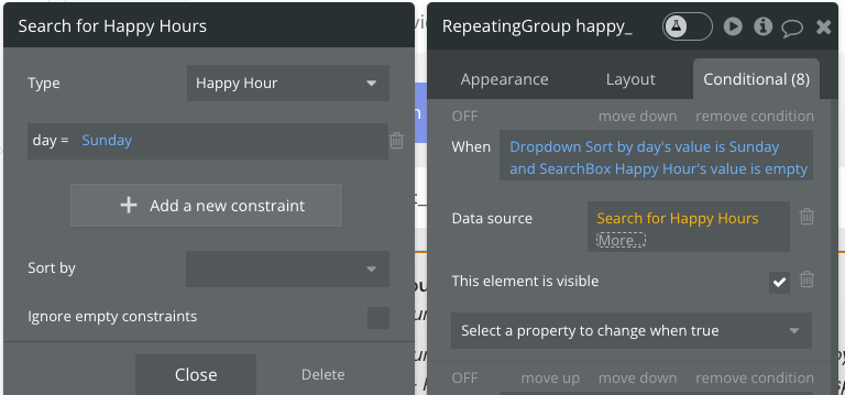

Here’s an example of the conditions on the repeating group. There is one for each day.
I added the “and Searchbox Happy Hour’s value is empty” to the end of each condition and added one more condition that allows the searchbox to work.
So, now it works!

Having this many conditions does seem a bit much and maybe unnecessary. Is there a reason why you cannot use “Search For: Day = Dropdown Sort by day’s value”? But this would be more like a filter than a sort.
For a sort you could directly use the “Sort by” field and select “day” (but this field needs to be a number then). And select “Ignore empty constraints” so that if the dropdown is empty the sort is ignored.

I did what you suggested and it’s working perfectly now. Instead of having nine conditions I now have two. One for the search box and one for filtering by the day of the week. Thank you for your help!
