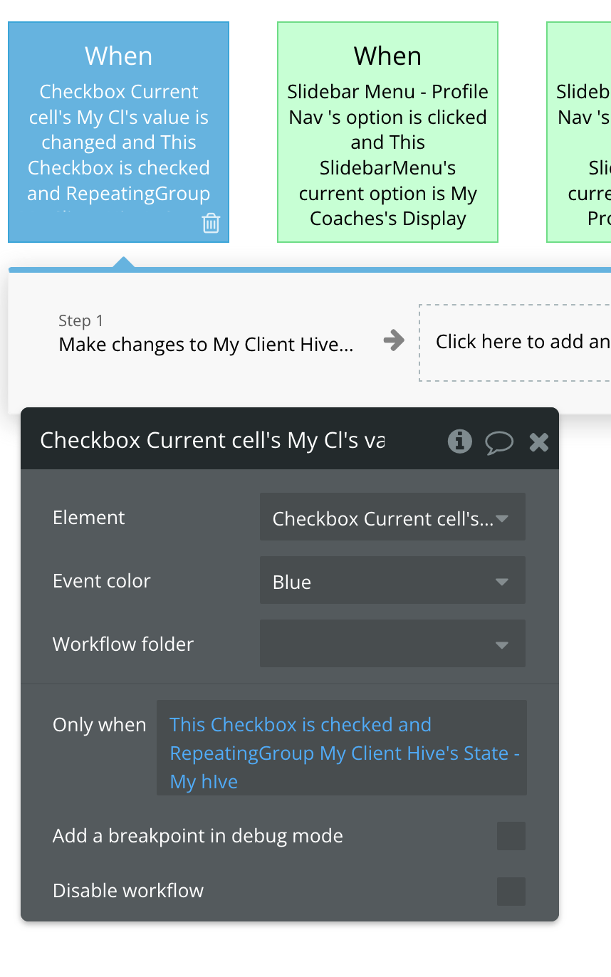

This what I currently have set up:
  1. The form for the user to make their selections in the RG:
  2. Set the state in the RG:
  3. Event - when they click on the checlbox:
  4. Update button:

Let’s say you have a field “friends” in Users DB. The friends field is type “user” and is a list.
The RG is set to User for type and data source.
You set a state “selected friends”. This state is type “user” and is a list.
You set two WF
A) Trigger: input value has changed (checkbox). Condition: This checkbox is checked > Set state RG “selected friends” = RG Selected friend:plus item curent cell user
B) Trigger: input value has changed (checkbox). Condition: This checkbox isn’t checked > Set state RG “selected friends” = RG Selected friend: minus item curent cell user
Button save wf: Make change to current user, friends field add list RG selected friends
Right. And what if instead of being on the Users data type I have a custom daya type called Hives that contains the names of Hives that a user can join. For each Hive name I want to associate the list of users that joined that hive name by selecting the hive name in a RG where all the hive names are listed.
This is my use case I am trying to build.
With my example, you should be able to transpose this to your case
I guess ou have Hives datatype and you should have the same field as a list into the user DB.
RG state and type will be hives
When user check or uncheck , update the state with the current cell hives
Button click to save, update user will the state.
