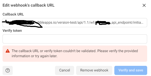

I am trying to setup webhooks for whatsapp business but when configuring the endpoint, whatsapp asks me for a verify token.
How can I add this verify token to my endpoint?

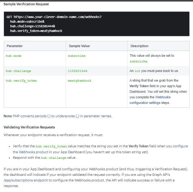

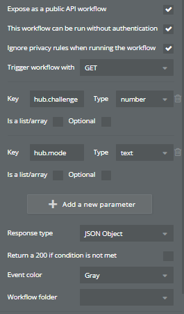

The verify token is mainly irrelevant (it is there so that YOU know it comes from Meta, not the other way round), what you need to do is set up the endpoint to be GET and configure the parameters manually (not with initialise).
Pass back the (using return data) hub.challenge (which is a number BTW).

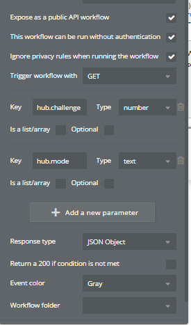

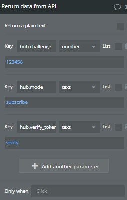

Hey Nigel! Thanks for replying.
Is this what you mean?
verifytoken
verifytoken4
verifytoken5
This is not working either.
Where am I wrong here?
It needs to be the hub.challenge that was passed in. Not a fixed number.

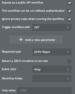

I think I might have not understand what you said. Do you mean this?
verifytoken7
Not working either.

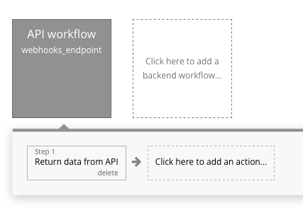

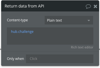

For anybody looking to do this, in the end, this is what worked:
verifytoken12
Thanks for the guidance @NigelG
