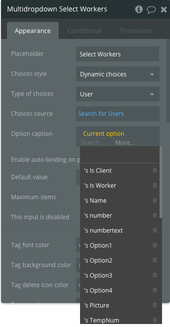

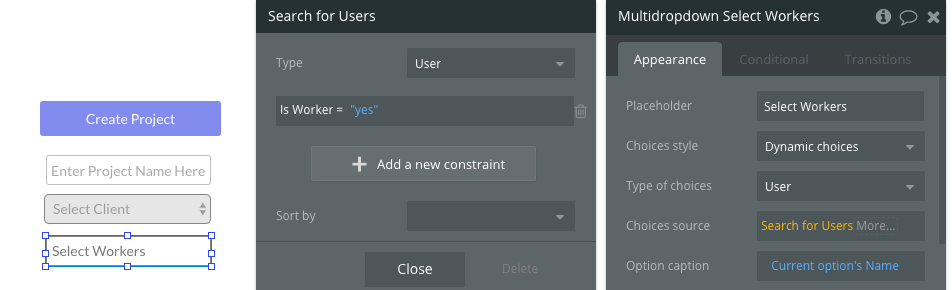

Hi @akerezy - I don’t have a video but earlier today I created a prototype that has both a multi-select dropdown (a free plugin) as well as a simple dropdown.
This first picture shows “Type of Choices” is “User” and the “Choices source” is a Search for Users to dynamically create the pulldown values (Users could be substituted for other “things” from your database)
Then for “Option caption” (that actual values that’ll show up in the pulldown), the following picture shows “Current option” then you choose whatever field in your “thing” (for my prototype is was “Current option’s Name” which is effectively User Name from my database)
Here’s the link to the prototype. While not a video, hope it helps
