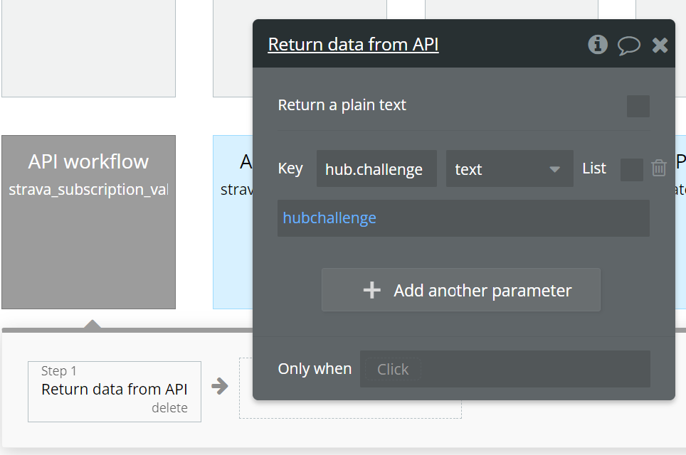

It does, here’s my challenge though… the backend workflow needs the parameter named as “hub.challenge”. Bubble won’t accept the . below:
I can define that with the “.” in the Return Data from API call:
But my guess is that since the initial isn’t defined correctly with the “.”, it’s not grabbing the parameter from the URL. Is there another way to do this?
