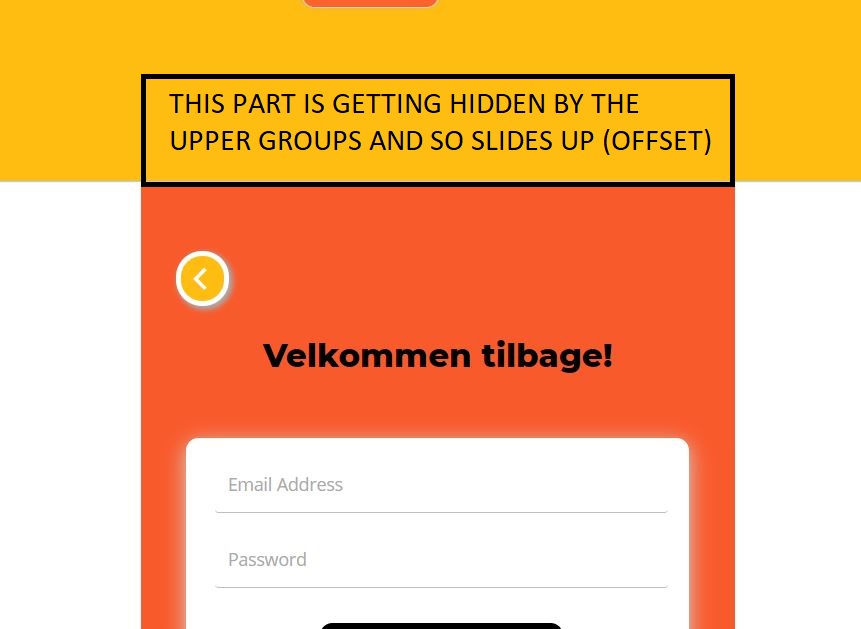

Hard to see from my phone. Maybe try this:
Try making sure this one collapses and that there is no extra space between it and the group above.
Hope that helps! :blush:

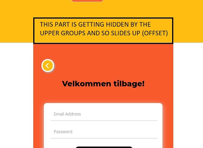

OK I found the problem. Ignore what I said about the FG. What’s happening here is that the group above the login group partially overlaps with the login group. The vertical stacking of the groups needs to be perfect - there should be no overlap, or no spaces, between vertically stacked groups. As a result, the login group is getting shifted up.
Group 1
Group 2
Group 2
should be vertically stacked, not overlap, and have no space between.
See my second reply above, and arrange the groups like shown below.
Untitled
Thank you very very much for your time and answer… Life saver
This fixed the cutted element completey. Thank you so much
