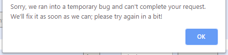

(Just for the record, what the user sees of this error is this:

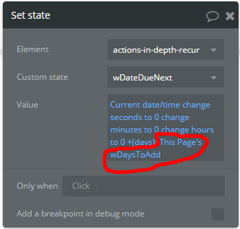

Here’s the step that is causing the problem:
If I replace the circled bit with 1, it works. The custom state wDaysToAdd is referenced successfully in previous steps where its value is set.
I’ve dissected thing as well as I can and this seems to be the cause. But the reality is that the custom state is in fact available.
What can I do to get around this?
Since I just couldn’t let this rest, I spent another half-hour or so completely replacing the custom state: I deleted the custom state and added a new one with a different name. Then, I fixed all of the issues that resulted. Then, I deleted the workflow step, added a new one and manually rewrote the value statement.
Voila! The same error occurs.
I really suspect this is a bug in Bubble. That statement has worked for months. Now, it may be the cause of errors that are occurring in other pages that used to work.
I will report this as a bug, but if any of you developers may know what’s going on, please chime in.
This afternoon I received acknowledgement from Bubble that there is a bug. Hopefully, they’ll have a fix soon, like today. Otherwise I’ll have to do surgery to remove the feature that is broken by this bug.
