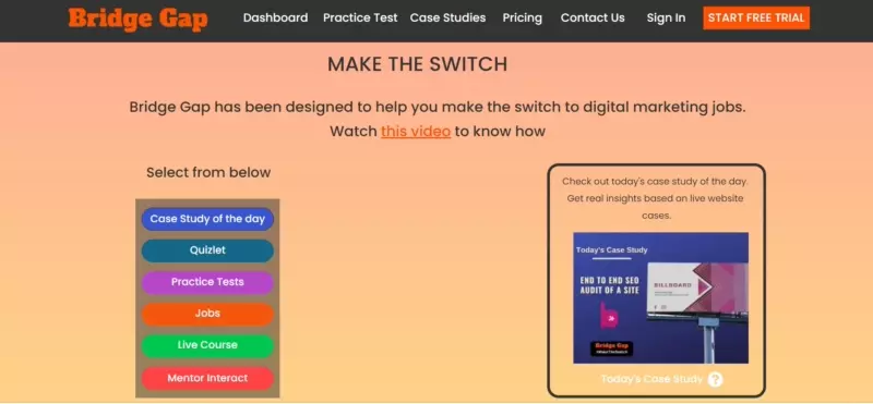

Hi,
I have gone through the entire thread and I have set the workflow as per the @fayewatson suggested.
In the header, I have created a Text element (case studies) and when the user clicks on it, it will display the Submenu (Group focus1), and when the user hovers on the Previous Case studies it will display another submenu (Group Focus2).
But the issue is when the user goes from one Submenu (Group Focus 1) to another Submenu (Group focus 2), Group Focus 2 gets hide
or you can say when the mouse moves from Group focus1 to Group focus 2, Group focus 2 hides.
I have made a short video on this
Group focus gets hide when mouse moves
Please let me know if I am missing any step.
Thanks

Try this:
Change GroupFocus2 to a group within GroupFocus1 that is hidden. Call it something like “Group Submenu”.
Create a Custom State within GroupFocus1 called something like “whichMenu”.
Show Group SubMenu when any of the menu items are hovered and set whichMenu to the appropriate state based on the menu item that is hovered.
Then within Group Submenu add 4 different groups, 1 for each sub menu, all hidden. Add a condition to each to show if whichMenu is this group’s value (1 - 4).
This will almost certainly work. The only downside is that you lose the relative positioning of the Group Focus 2, but that is a small price to pay to get this working flawlessly.
