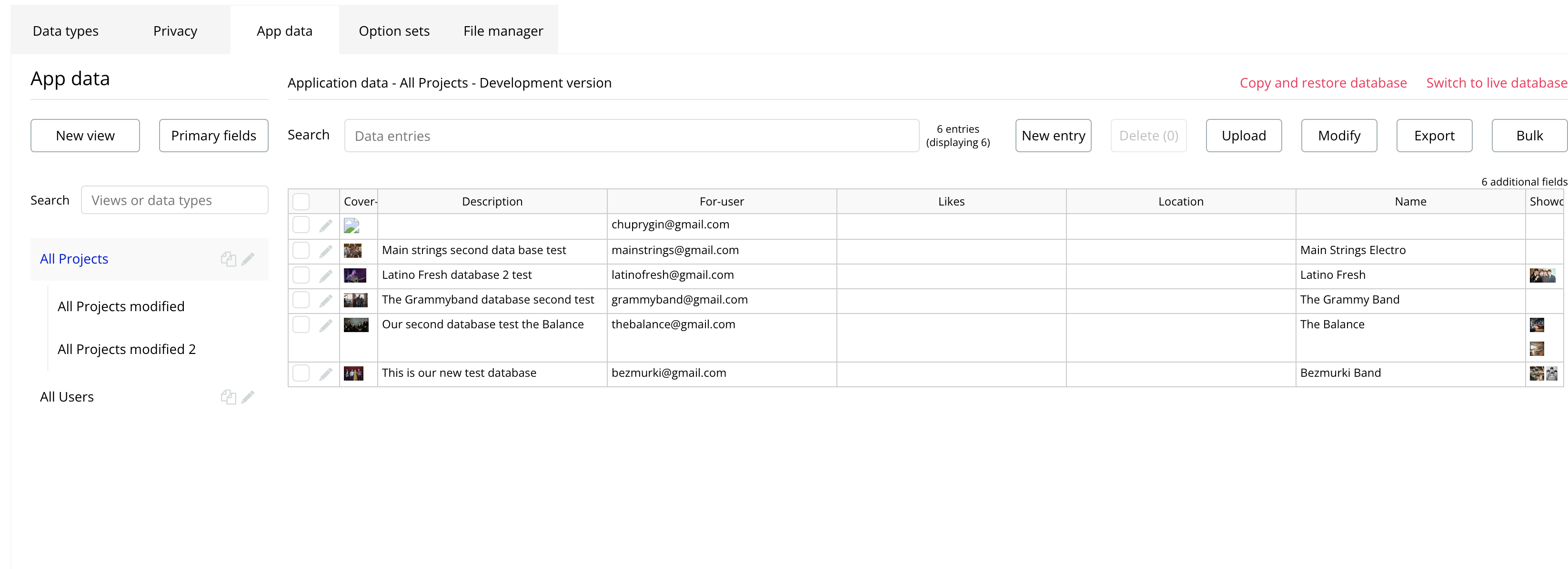

I have an idea, that maybe this issue is because when user signs up – it appears in the User data type base, but the Project data type base stays empty. I thing I have to set the workflow so when user sign’s up the new related project data base cell also is being added as a related on to current user… Does it make any sense? :sweat_smile:
On the screenshot the new signed up user is Vladimir
But there is no related cell in the Project data base
You need to pass the Project data through all of the groups if you’re using Parent group’s X, there’s nothing else to it. Make the Parent group not empty and your autobind will work.

You can see from your database screenshots that Vladimir’s project is empty.
Create a project, and make changes to Current user so that Project = Result of step X (Create a new Project).
Wow! Yes! Now it works! Thanks a lot:)))))))
