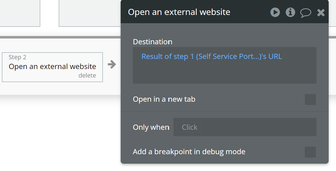

Hey guys, I have a problem I’m trying to solve for days. I’ve downloaded the Stripe Customer Portal Plug In and everything works fine (I get the Stripe Customer ID and everything, I can receive payments etc.) but when I then want to configure the “manage subscription” option I get an error whenever I want to redirect the user to the Stripe Customer Portal where they could e.g. cancel their subscription.
I have configured the workflow like the creator of the newest Version of the Stripe Customer Portal has showed in his youtube tutorial. Below you can see the details of the workflow.
I would be super grateful if someone could help me!
Thanks in advance :slight_smile:

I am having the same issues, I have been using and testing for a couple of months now and it was working until now :frowning: I haven’t changed any information. Your workflow looks exactly the same as mine, but I keep getting “You didn’t supply an API”

Thanks! Worked well. I did have an error when I first followed the tutorial, only because I put my live key in where the author placed his test secret key.
I put the Live secret key where the test key should go. I moved my live key to “key value” and left the development key value blank.

The most common thing that causes this issue is API key setup. I suggest checking out my demo app to see how I’ve set it up. I can also see from the screenshots above that you do not have a “Return URL” specified - you will need to do this.

Not that it matters now but all you needed to do was remove the debug mode element of your Return URL. Hope your platform’s doing well :rocket:
