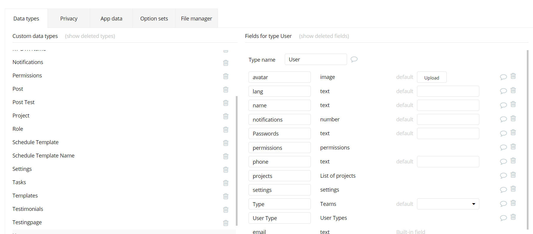

Hey Mark,
I think you made it over complicated to be honest. In your User data type, you have two fields:
  • Type, which is of type Teams (what is this option for?)
  • User Type, which is of type User Type (either internal or subs)
I currently don’t see how these are related to each other? Are the options in Teams the same as User Types?
A way to make it more simple would be to only have one field User Type of type text in User, and set the value of this field to either internal users or subs/vendors
Then you could have a similar text field in Post depending on which user type you want to show it to. Your constraint visible = Current User’s Type would then work

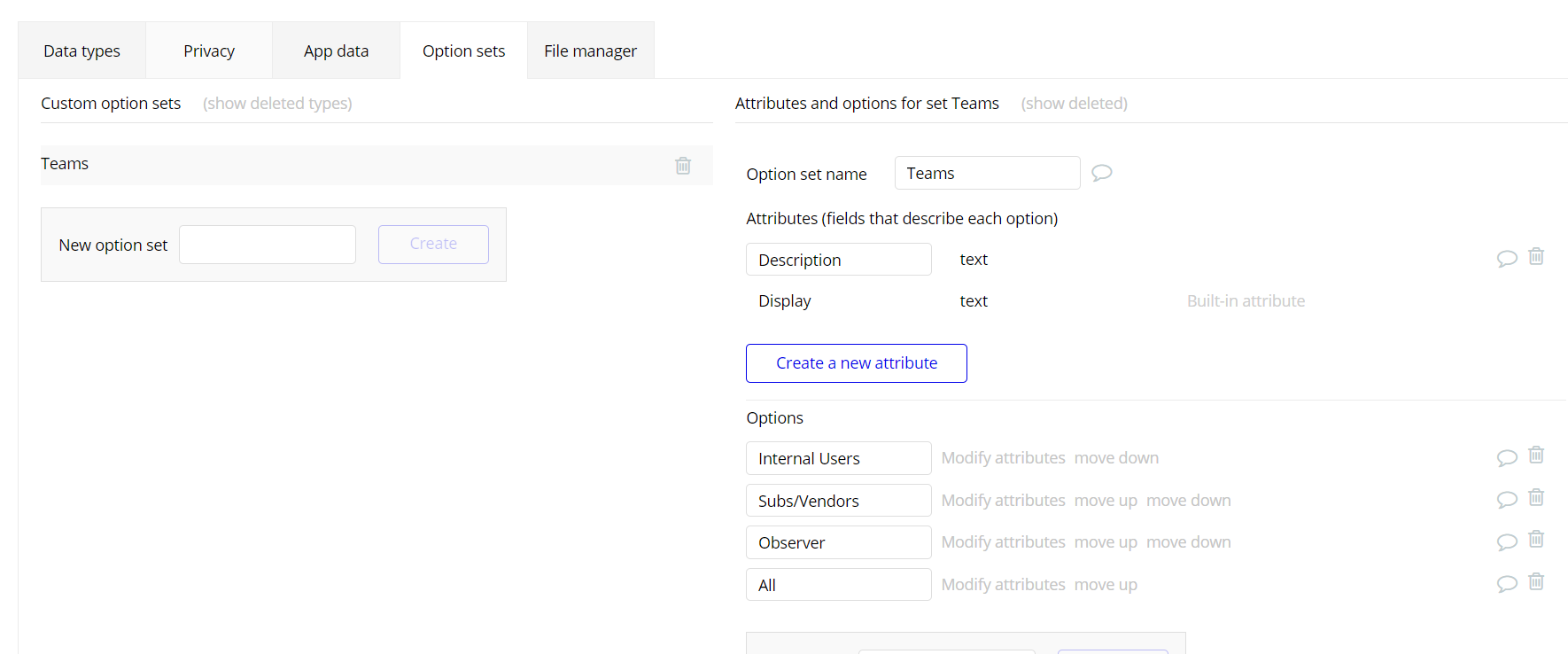

Hey ambrose, thanks for replying!
Teams is an option set. I made “team” so I can add a dropdown and I can choose from that option set. I made “User types” so I can change the User type for users and if the user type is = to the dropdown value then it is visible to the current user. I thought that way is the best to go so I can choose what post is visible to what type of users. I understood your way but there is some limitations. So lets say I added a post and I need it to be visible to internal users and subs, I don’t think there is a way to do that because then I have to remove the constraint from the RG data source “search for”. I can replace the dropdown with a permission table just like in the image below and if the checkbox is checked, this post is visible to the checkbox value.

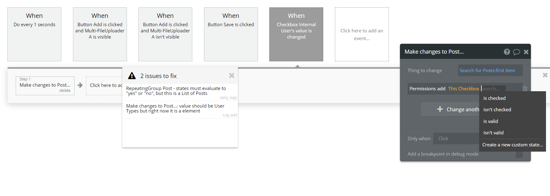

this is showing up. What should I do about this? am i doing something wrong?
do you need the editor link? I think it will be easier for you
@grace.hallak
In the Make changes to Thing window, instead of setting the Thing to Change to Search for Posts’s Permissions, just set it to Search for Posts’s first item (you could even set it to Current Page Post I guess?)
Then select the field Permission
okay it is showing now to change a field
there is no this checbox’s value
Okay, just don’t forget to have two workflows: one when checkbox’s value is changed and checkbox is checked, and the other one when checkbox’s value is changed and checkbox is unchecked

Okay @grace.hallak so I have changed the Permissions field to a list of text and have done a couple of workflows to add or remove Internal in that field when the checkbox Internal User is checked or unchecked
The fact that your User Types fields are yes/no complicates it a bit, but it will work when you set a condition When This Post’s Permissions contains Internal and Current User’s User Type’s Internal Users is yes -> this post is visible
