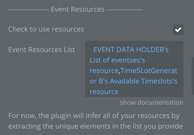

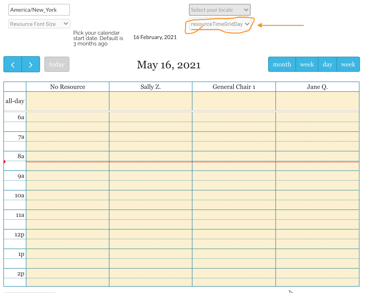

this shows how to set up resources
1 timeslots element could be added for each resource so that timeslots can be created on the fly. for each resource. i will add a ā€˜resource out’ option for the timeslots so they can be assigned as such. just completed this feature.
in the example i provided there are several resources. perhaps they dont all work every day. now you can provide timeslots for each resource on any given day of any duration and starting at any time!
and yes, the resource name pops up at the top of the column as long as you provide them.

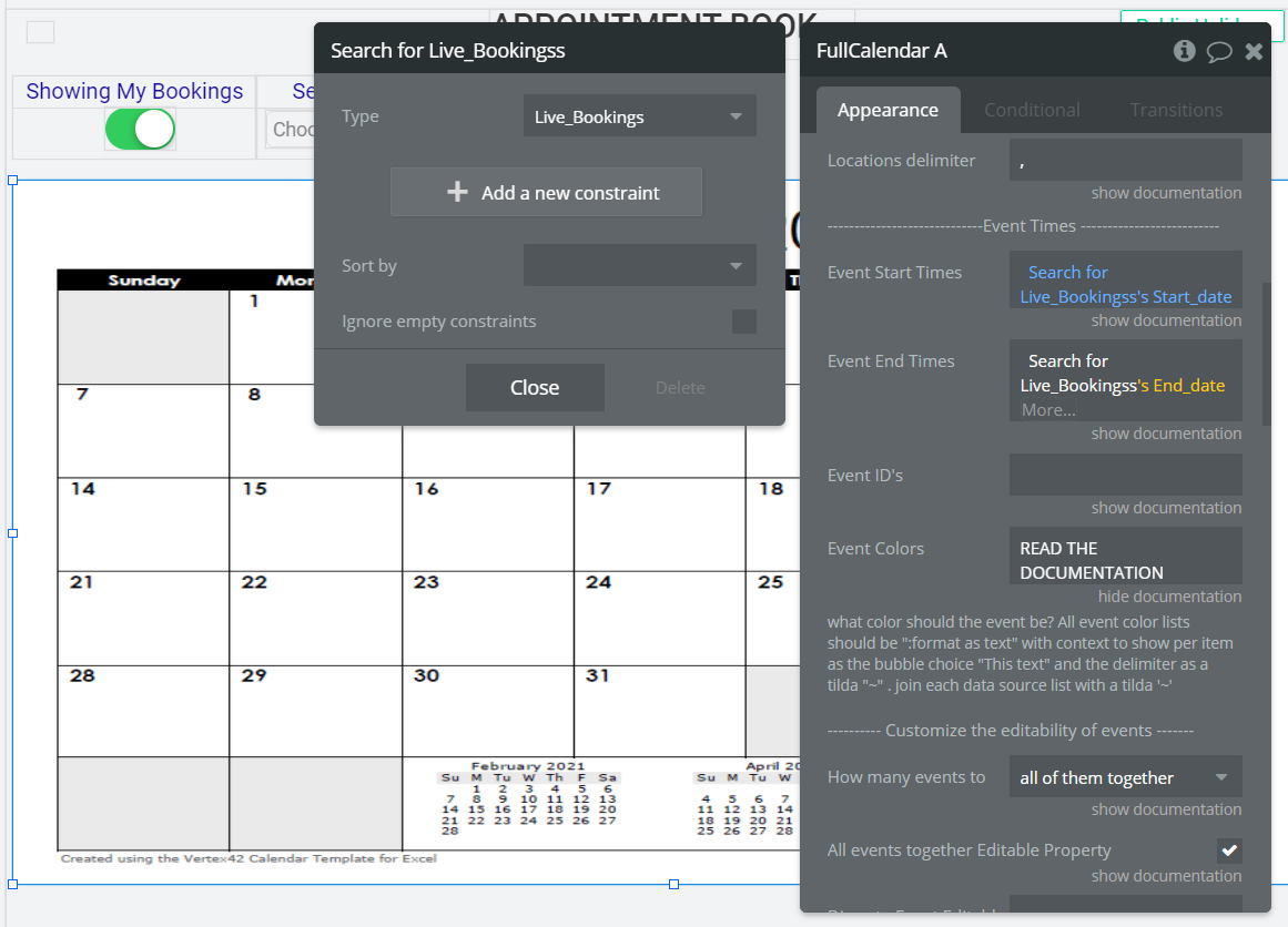

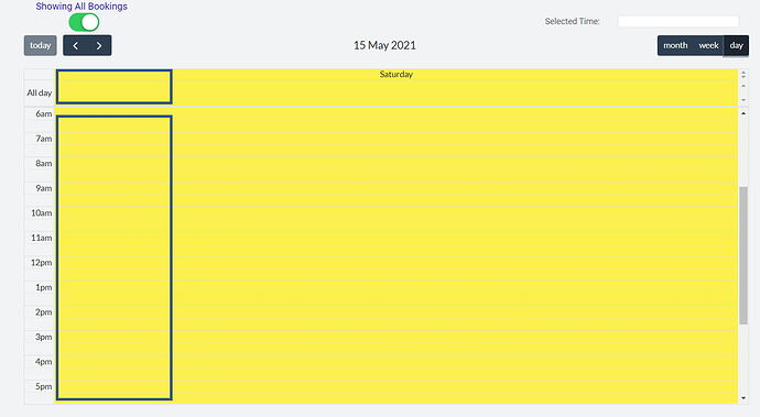

I cloned the page containing the calendar, deleted and added your FullCalendar.
Below is where I am at in terms of adding columns for each User who is a ā€œGroomerā€.
I guess that how I handle the comma separator will be explained.
Also, when I selected resourceDayGridDay (a) I don’t see times of the day and (b) when I click below a person I see the day calendar. I assume that is where I add an appointment.

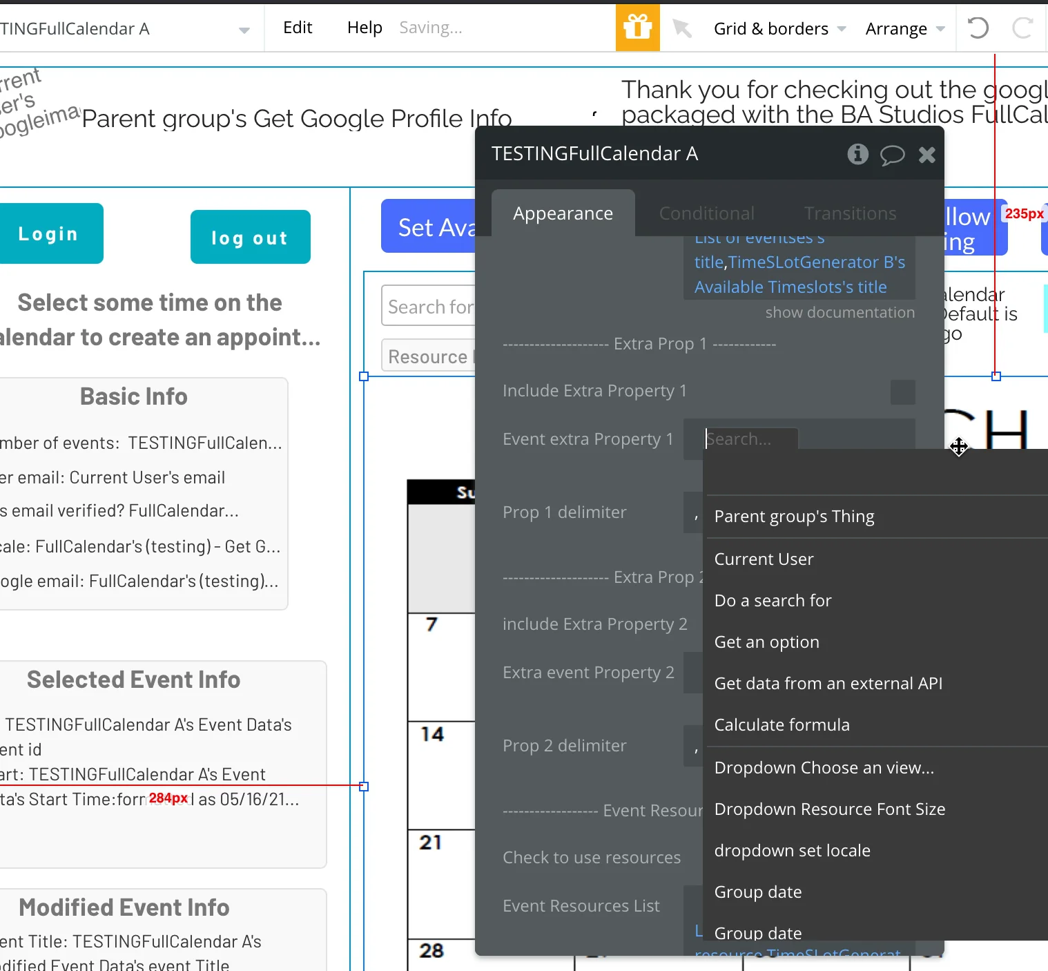

your screenshot is of the field from which titles come. below is where you’d add the resources. i imagine each of your groomers has some sort of employee ID or Name field associated to the record. I’d use that for the resource name most likely
Screen Shot 2021-05-16 at 8.13.50 AM
It’s tricky at first but once you do it twice, you’ll find it to be super simple. the idea here is that i wanted to allow for several data sources to input data. your DB plus the scheduler. In this journey i found that sometimes a title (or other fields) have a comma in them and when joining data sources this way it presnts issues.
so
for any field that may have a comma (be aware event colors always require this trick) use this trick
i think, you are looking for this view in particular. you could assign this to a bubble button or enter this view on initialization or via a workflow action.
To make an appointment, you could :point_up_2:click and drag on the calendar :date: to create a Timeslot but you could also create a Timeslot more rigidly with date/time setters. Using the Timeslot element you could restrict bootable times to a preset range of events and not do anything when someone click/drags on the calendar. I can add the option to disable this click/drag in the future for this exact case so as not to confuse anyone.

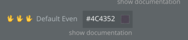

@marksrunge , you should be able to not have to worry about setting colors for each event anymore.
you now have 3 options for colors.
set each event itself
Screen Shot 2021-05-17 at 9.43.53 PM
set a default and leave the above blank!
Screen Shot 2021-05-17 at 9.43.46 PM
orrr set the color by a different field. an event identifier like Homework/Chore/Job Task/Something Special for the Honey/etc
