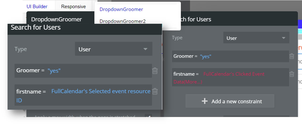

Conditional data source problem using Fuzzy Search & Autocorrect
Hi
Please check the screenshots and comments below.
My conditional data source causes problems so I need an alternative way to show all on load.

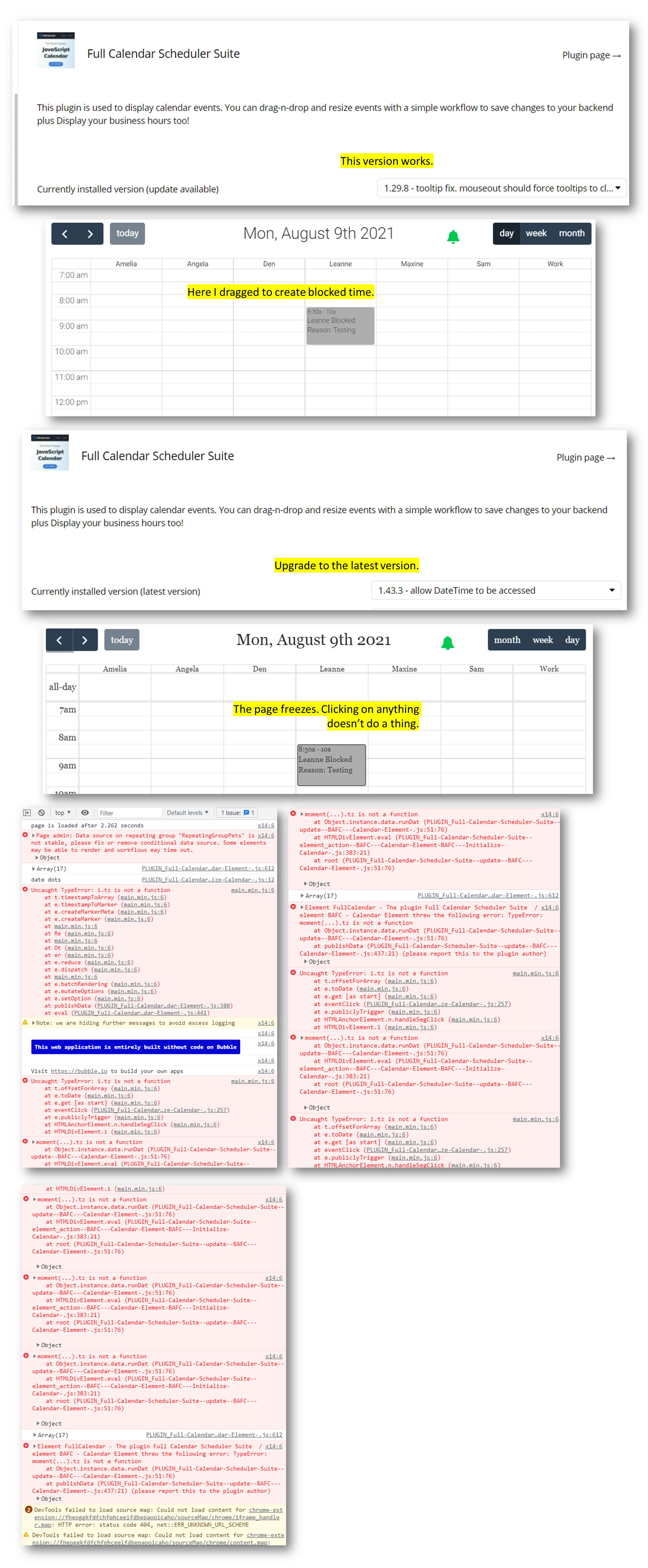

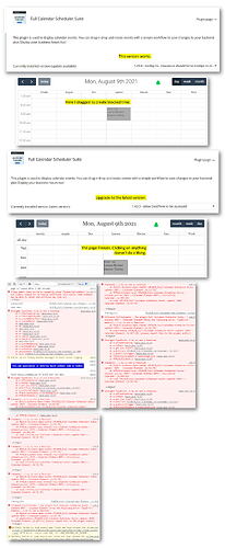

Below are screenshots and explanations.
I was using the version that works when asking the question.
I didn’t want to confuse the issue by showing what happens when I update to the latest version.

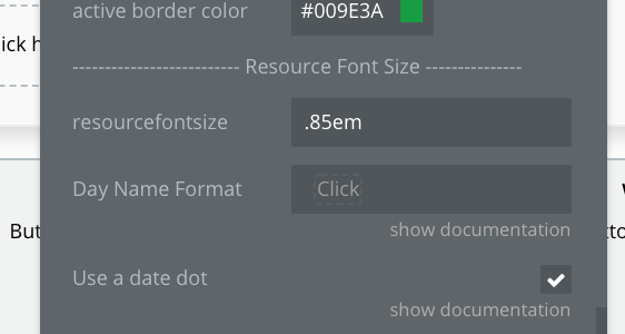

i found this to be empty so filled it in with ddd

Yep. Just showing what breaks after the upgrade (see example below. The error is red from after and the blue is what worked before.

Sorry. The old version is up so I could find what worked before.
Upgrade to the latest version of your plugin and it won’t load.
And you’ll get the 11 issues such as the screenshot I just sent to you.
looks like you’ll have to fill in those properties. not sure why they broke, but you just need to reset those values.
Cool. Doing that now.
