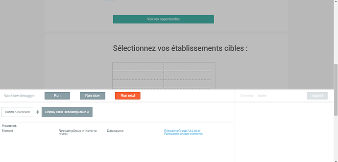

Have you tried using the debugger to see how the list is calculated? Click on Inspect in run mode and click on the repeating group, you’ll be able to see how the list is evaluated. If you still have some issues then, let us know here and we’ll look in greater details.

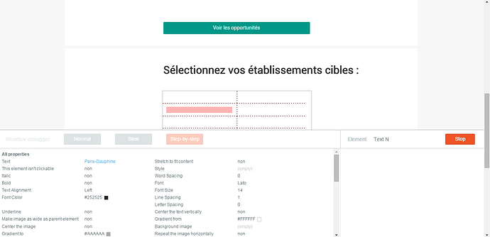

I have tried using the debugger. The workflow is calculated in the right way:
It is weird: when I inspect the “group text” elements, I see that they contain the right text, but this text is not visible on the page:
Above, in the selected cell, I find “Paris-Dauphine” with the Debugger (which is the expected university name), but nothing appear on the page.
That was an issue with your design, your text element in the first cell was too small, so in edit mode it was showing ‘…’ and in run mode we make it so that it shows nothing. Be careful with … when you’re editing texts, they’ll be hidden in run mode.
Should be fine now, made the text bigger.
