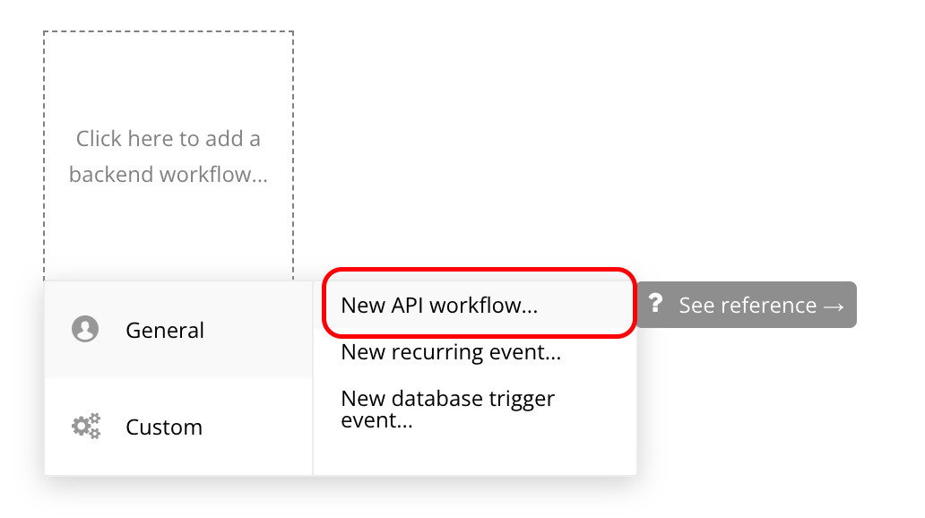

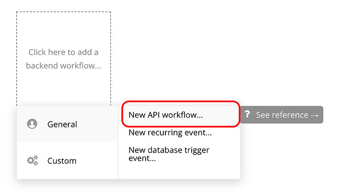

  1. Go the “Backend workflows” page of your app
  2. Create an API Workflow by clicking on “Click here to add a backend workflow…” and selecting General > New API workflow…

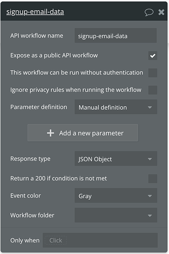

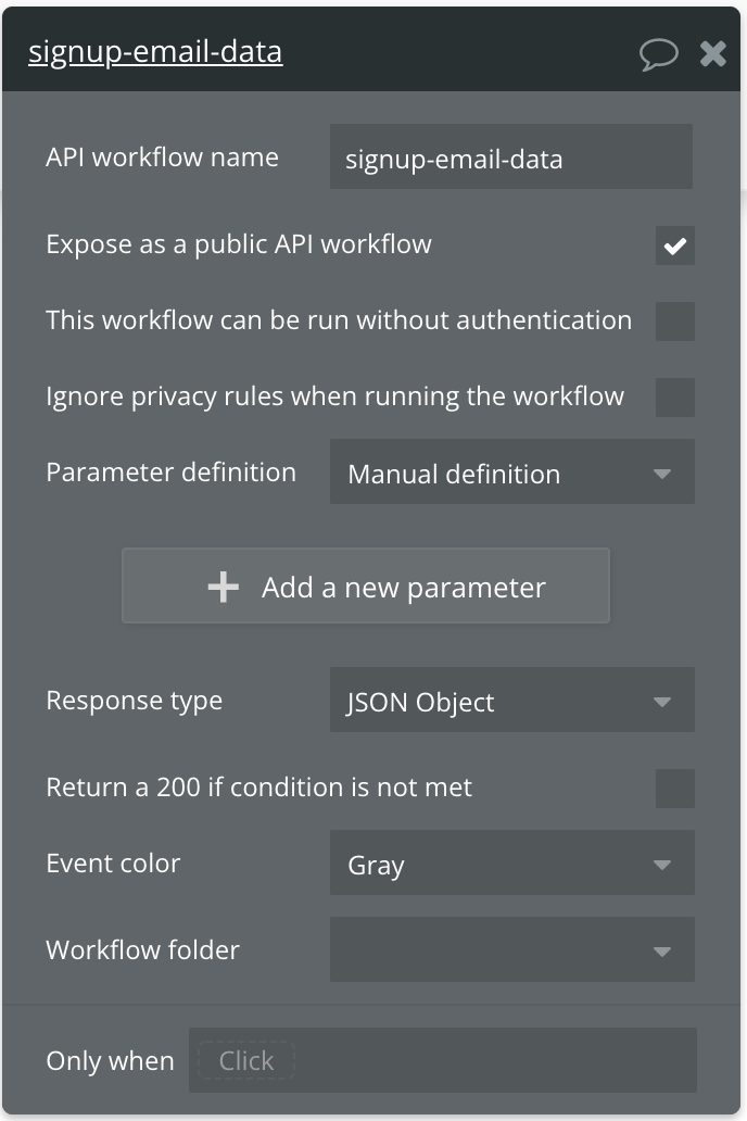

  3. Name the workflow whatever you want. I’ll name mine signup-email-data

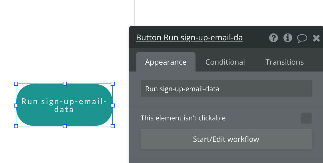

  8. The last part is to run this workflow. We can do that by creating an extra page in our app to run workflow’s like these. I have a “develop” page for this. On the develop page, create a new button and name it something that will remind you what it does.
  9. Click on the button and select “Start/Edit Workflow”. You’ll be taken to the workflow tab, with the workflow started for this button. Add a step like before where you go to Custom Event > Schedule API Workflow. Select the API workflow we just created “signup-email-data” and put Current date/time for the “Scheduled date”.
