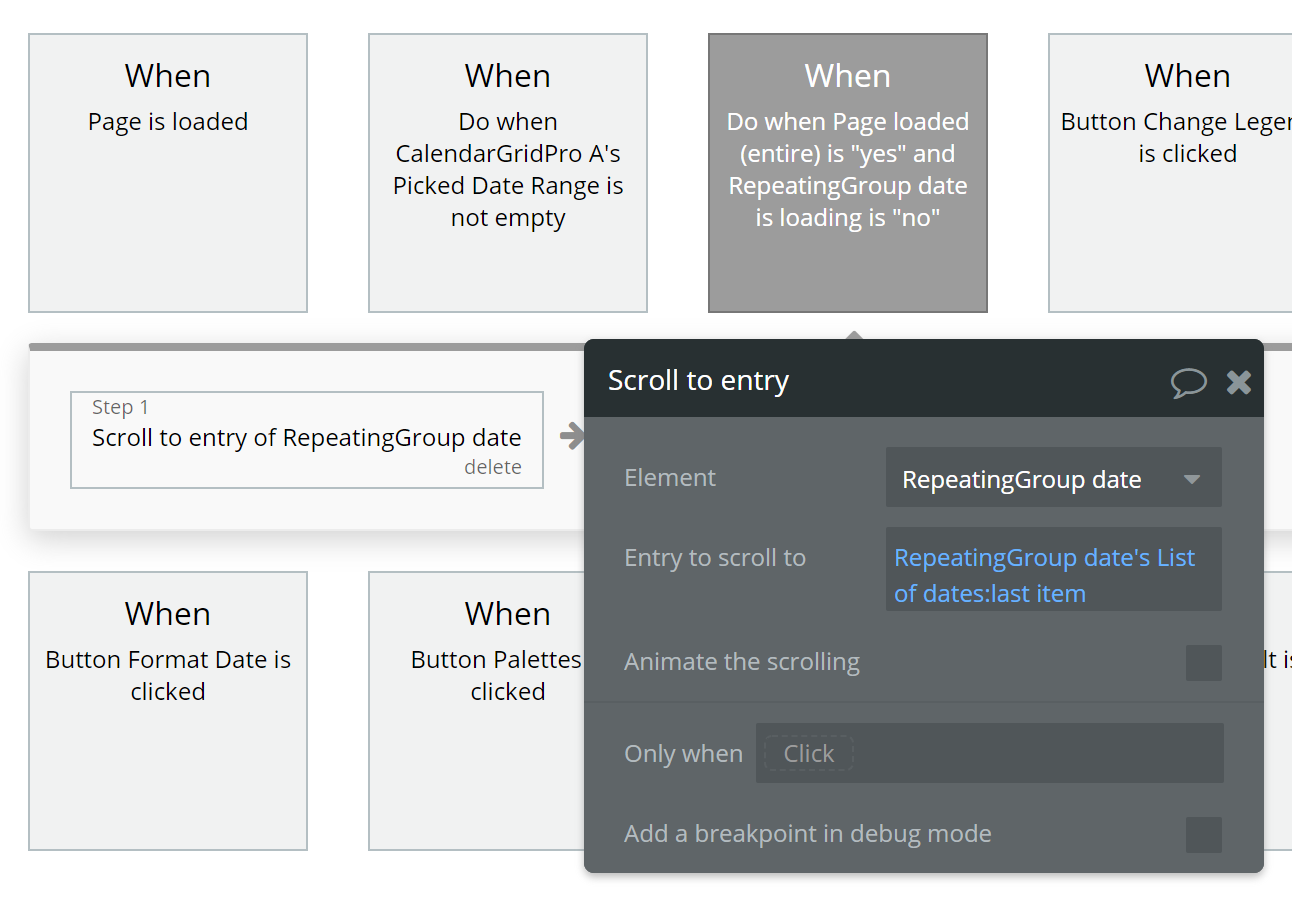

There’s an Action for Repeating Groups called “scroll to entry”. The trick with your use case is that you can’t just trigger it on page is loaded, but I find that the following works:
You build the condition as follows:
NOTE: The EVERY TIME setting is important here:
This is because the there’s no Event that gets fired by RGs when they are done loading. Instead, we must monitor for changes of the “loading” state. This starts off as “no”, goes to “yes” and then back to “no” once your data is finished loading. If we don’t have “Every Time”, the scroll to action will fire before your group is done loading and will not scroll to the proper position.
So there ya go.
An ugly example of how this will look after page load:
