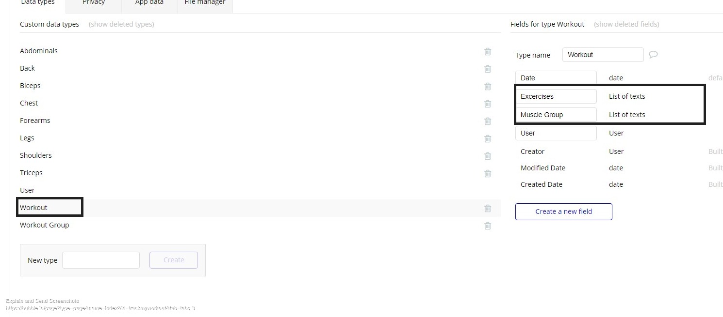

Please see below screenshot. I can’t seem to get Biceps and Chest on two different buttons. I have 3 horizontal rows in my repeating group.

The data field muscle group where you have: biceps, chest, added manually: is that a text or a list of texts?
For me list of texts can be displayed in an RG type text e.g. showing this exercises’ muscle groups text. If on buttons not an RG you can use the lists of texts first item on one button, lists 2nd item on another button etc.
If it is instead a text and you want to have every comma mean a new line, you can use regex. I can let you know which regex if that is the case.
I see your updated response. Button need to .be in a RG of type text. Get data from thing’list of text:unique items
On button, use current cell text

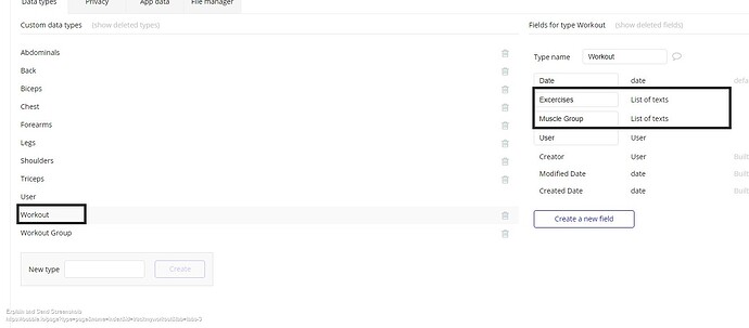

Please see attached images.

The setting look correct. But I believe that maybe your multidropdown is not saved correctly to db. Can you show this specific workout from DB
I’ve added images.
Yes. Me it was to use a list of text and instead joining with a comma, join with new line. In your case your start from a text and create a list of text. Anf I believe that it may now be a solution for this case if the text is not really a list of text.
