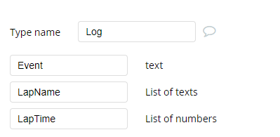

Since these are custom states, and I don’t want to stop the workflow that’s being timed, I attempted to write them to a log file that looks like this:

What got written to the log file is empty:
I have clearly reached the limits of my understanding of Bubble and the Stopwatch / Timer plugin.
Can you help me understand how to use this? I really need to improve the speed of some workflows and right now I’m flying blind.
