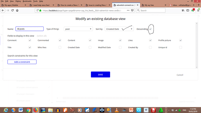

i want the latest post to be top of my news feeds, how do i set that? right now the old post remains at the top whilst the news post are placed below…

Try sorting by date. Maybe that will do it.
current date goes below…thats the setting i have. even if i uncheck the descending box nothing seems to change?
Ok, I see where you are at now, thanks for posting a picture.
Where are you displaying your results? In a repeating group?
BTW, that view you are looking at just allows you to view data, it is not displayed like that in your app unless you tell it to in the app itself, not on the backend.

In the repeating group there is an option to sort: where you can’t put the creation date as a criteria and allow it to be ascending or descending. That should do it for you. I hope.
