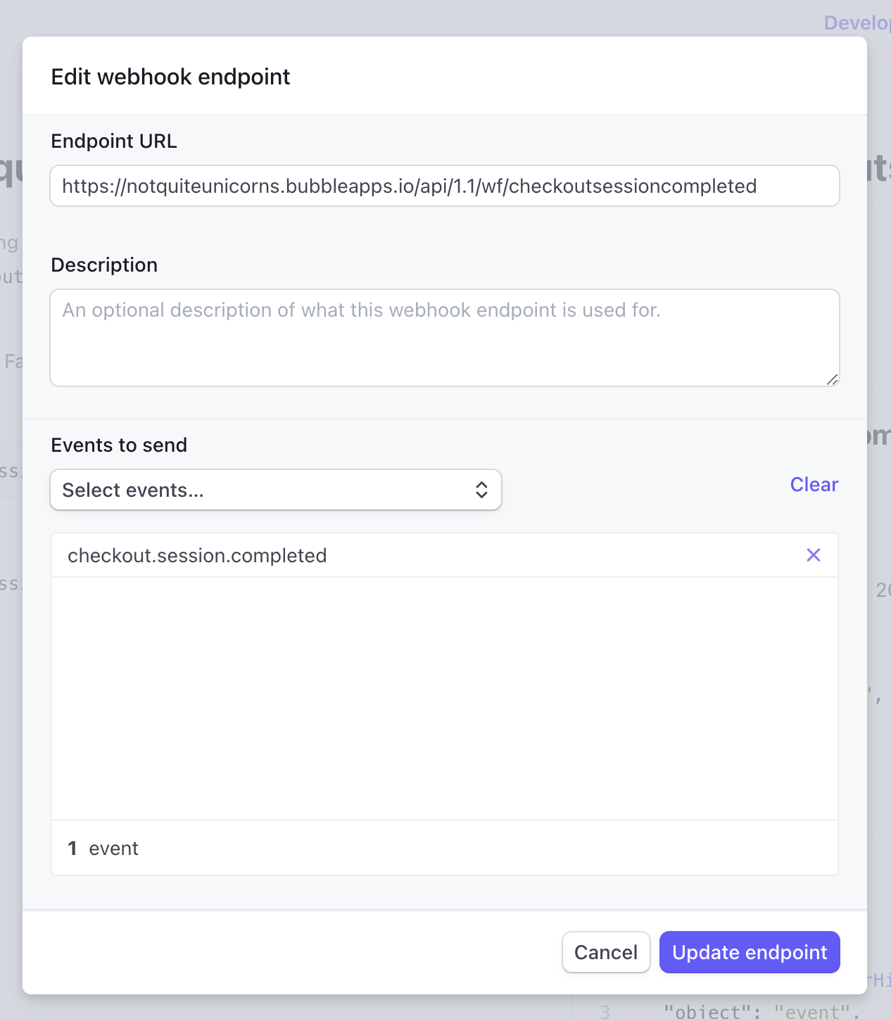

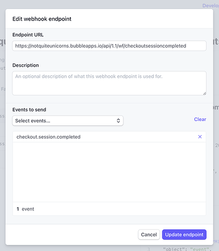

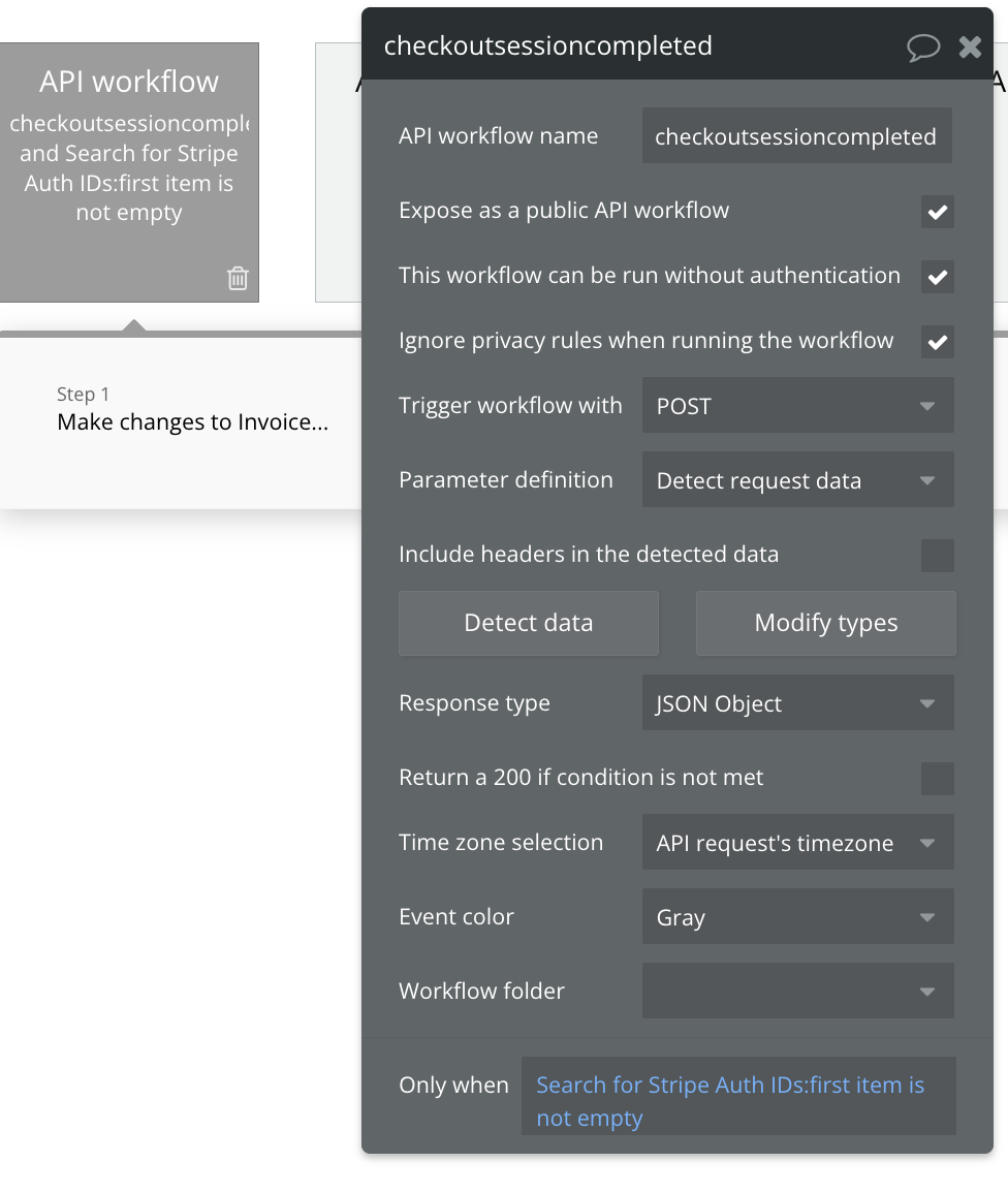

I create a checkout session with metadata of invoice ID for a fixed amount and then have a webhook for the checkout session completed event in Stripe. Then I just search for the invoice where unique ID= checkout session’s metadata ID and update its status to paid.
If you’re creating a PaymentIntent there’s probably a similar webhook for that.

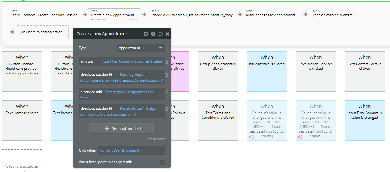

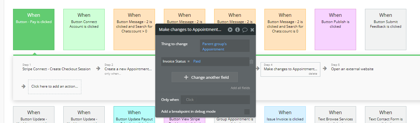

Ok thank you so much for your help. Honestly I’m not that familiar with webhooks, would you mind taking a look at my workflow? Basically I just did a very simple method where merchants update an input for a specific booking in their repeating group and an input in the customers repeating group of bookings gets updated with a final price and the customer then clicks the pay button and gets taken to stripe checkout for that amount. Here is the workflow I have set up.
Ignore the condition
