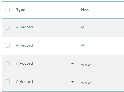

My website is not showing "www" after https://
Hello bubblers I need help setting up my hosting with Namecheap, my website is not showing www after https://
It wasn’t like this before so I was wondering if I’ve modified something by mistake.
This is my current configuration:
Cature
Just guessing but that dot at the end of www might be the problem. DNS names that end with a dot mean it is a fully qualified name - which is not what you mean here.

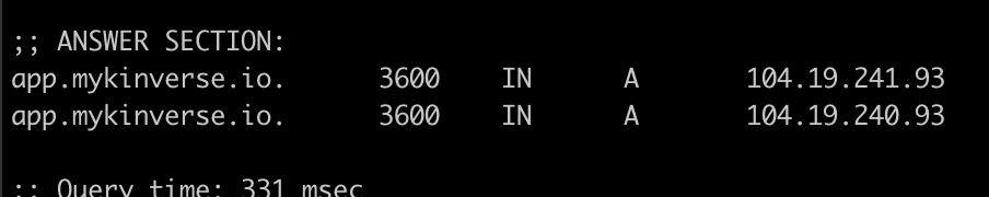

Also to connect your subdomain to Bubble - your A records wouldn’t normally point to www
More likely something like this
