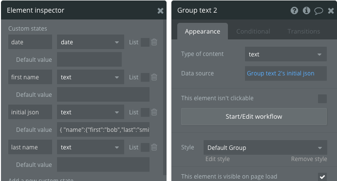

Hey @jon2 , it could just be me but i’m finding the demo a bit difficult to follow. I’m trying to figure out how to read from the server, but the server demo seems focused on writing, with emphasis on read/write to the page. I’m not seeing values appear in the DB nor do I understand how to query the DB and parse the json.
Here’s where I’m at. I have manually entered a JSON value into a text field in my DB. I assume I need to have a “read/write JSON(bulk)” element on the page. At that point I’m lost. I don’t see anything in the demo that helps me to retrieve and parse a stored value. Is there anything in the workflow that must be done? I found the following but i’m not sure what is and isn’t necessary to be completed.
Update:
Taking a look at the custom states you have set, is “initial json” only to be used for writing, with the others for reading?
Important: Am I going to be able to access any of this dynamically inside of a repeating group?
I’m going to keep playing around with it but any additional documentation you might have would be helpful.
Thanks,
Chris
The local and server-side demos are essentially the same except one is performed locally, the other is performed via a server-side workflow action. The output destination for each demo is the multiline field on the page. Nothing is saved to the database in the demo.
I’ve modified the demo page for clarity and make them more similar to each other so its clearer what the intent is. I renamed the confusing state that was called ‘initial JSON’ to just ‘JSON’ which is the both the source and the destination of the JSON for each workflow,.
The demo is built this way is on purpose and demonstrates how you can read from and write to the same JSON object using the same workflow action step, by simply modifying the read parameter,

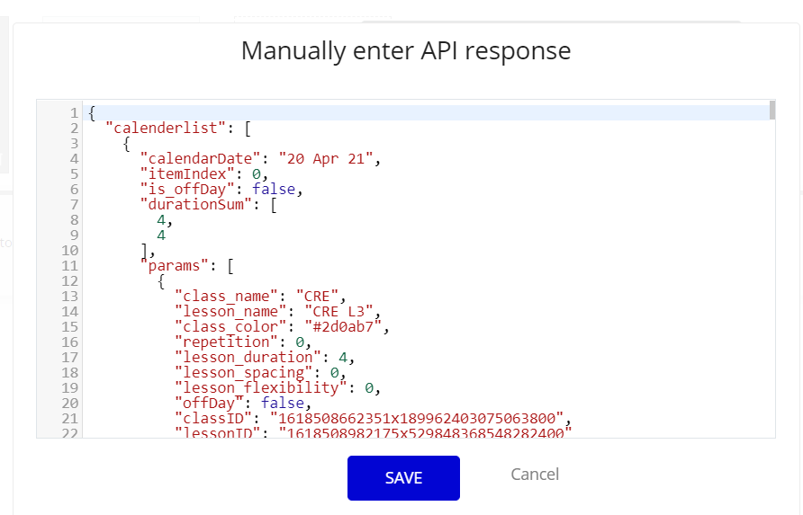

Hello @jon2 , I am having issues storing/reading JSON data from API workflow another website.
“calenderlist”: [
“calendarDate”: “20 Apr 21”,
“itemIndex”: 0,
“is_offDay”: false,
“durationSum”: [
4,
4
“params”: [
“class_name”: “CRE”,
“lesson_name”: “CRE L3”,
“class_color”: “#2d0ab7”,
“repetition”: 0,
“lesson_duration”: 4,
“lesson_spacing”: 0,
“lesson_flexibility”: 0,
“offDay”: false,
“classID”: “1618508662351x189962403075063800”,
“lessonID”: “1618508982175x529848368548282400”
“class_name”: “History”,
“lesson_name”: “His L1”,
“class_color”: “#1fd8d2”,
“repetition”: 0,
“offDay”: false,
“classID”: “1618508945961x100065777376559100”,
“lessonID”: “1618508967129x736282414062239700”
Here is what I have done:
Make sure the JSON you are supplying is valid. For example: The JSON you provided in your post fails the validation at JSONLint.com, so the plugin wouldn’t be able to process it.
… raw data
I think the JSON is OK this is how it looks in bubble. I had posted just a small part from the console.
