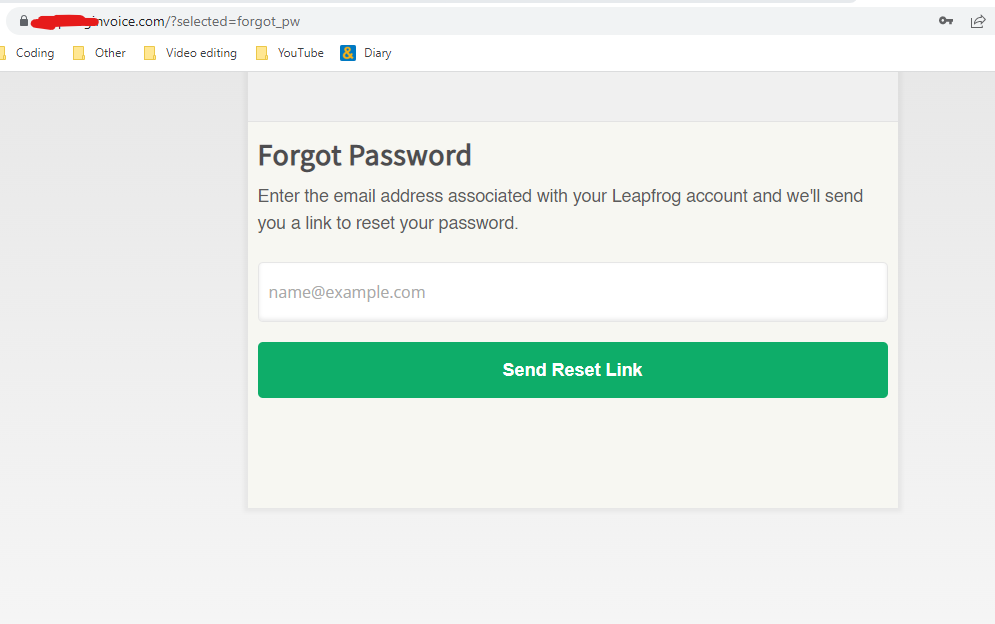

I previously had my password reset working for my single page app using SendGrid, but since changing from custom states to URL parameters for navigation, the reset email link isn’t pointing to the correct page.
Here’s the link (which worked) on my old app which used custom states;
Since changing to URL parameters, the reset password page is now found at mydomain.com/?selected=reset_pw so I figured the following should work;
Website home URL?selected=reset_pw=yes&reset=Result of step 1 (Send password res...)
However, the above is directing to a dead page? The resulting link which is generated for a user to click on is (I replaced domain but the rest is identical):
https://mydomain.com/?selected=reset_pw=yes&reset=1649795109459x916739841510752600

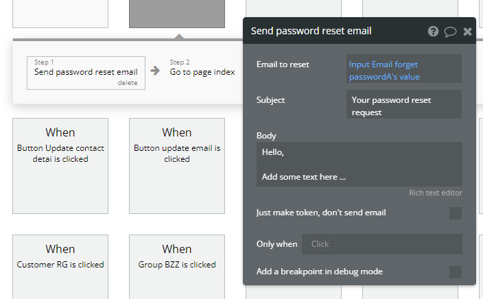

Any ideas why this workflow won’t send an email to me? I have checked but not there either. The following workflow is on a group called ‘forgot_pw’
No idea…
Is the workflow actually running (and you’re just not receiving the email)?
Or is the workflow itself not running?
The workflow runs and directs the user to the next page but no email is sent. I have tried different emails. Maybe I should contact Bubble support because this should work out-the-box?

I received feedback from Bubble support who said that I can’t use Bubble’s default messaging system because I am also using Sendgrid keys.
I have since managed to get the emails to send using Sendgrid. However, the link which is sent to the user does not redirect to the correct group, the exact group they need to get to is https://mydomain.com/?selected=reset_pw but (once the link adds the password reset code) the final URL looks like this https://mydomain.com/?selected=reset_pw=yes&reset=1650195367163x828710182414319100 and this is a page which looks like my website but the page is empty?
