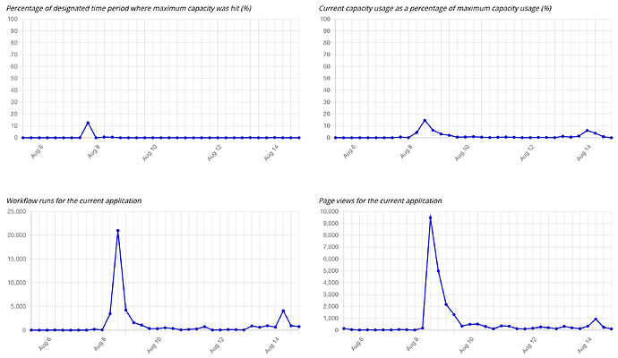

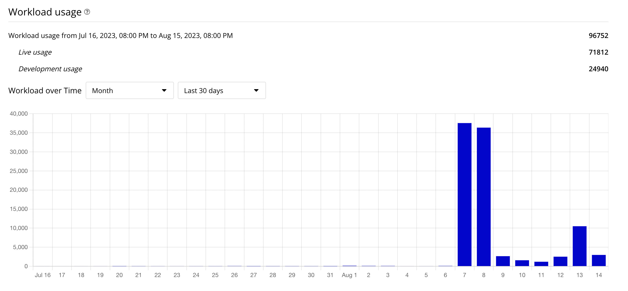

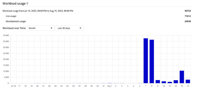

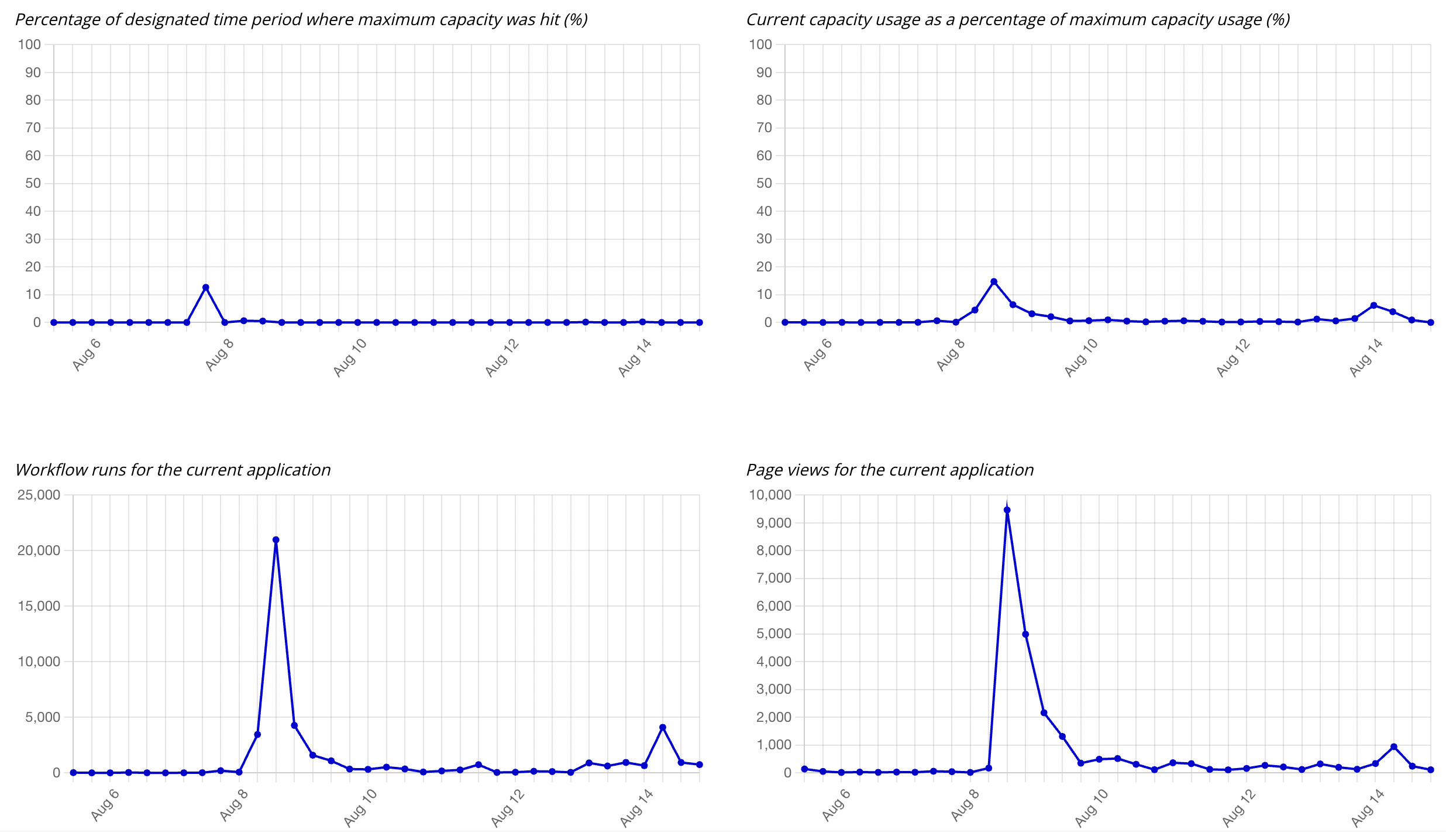

We just field tested this last week! Here’s some data:
I run a film festival and we released our decision letters for thousands of films at once. A lot of people logging in at the exact same time, similar to you, to check their results, and the personal legacy plan held up very nicely.
8,000-ish views in the first hour, 10,000 total that day (we released letters at 9pm), then around 5,000 total the next day, then a decrease back to normalcy. What we did is “boost” the application (you can do it up to three times) before that first hour.
If I remember correctly, a boost only lasts for an hour, though, right? So, that might help with the ~10k visitors in the first hour, but I’m not sure how it would help with the ~50k across the first week. I don’t know… if it was me, I don’t think I would trust boosts on the legacy Personal plan to handle what sounds like a pretty important event, but maybe I am not remembering correctly how that legacy plan stuff works.
