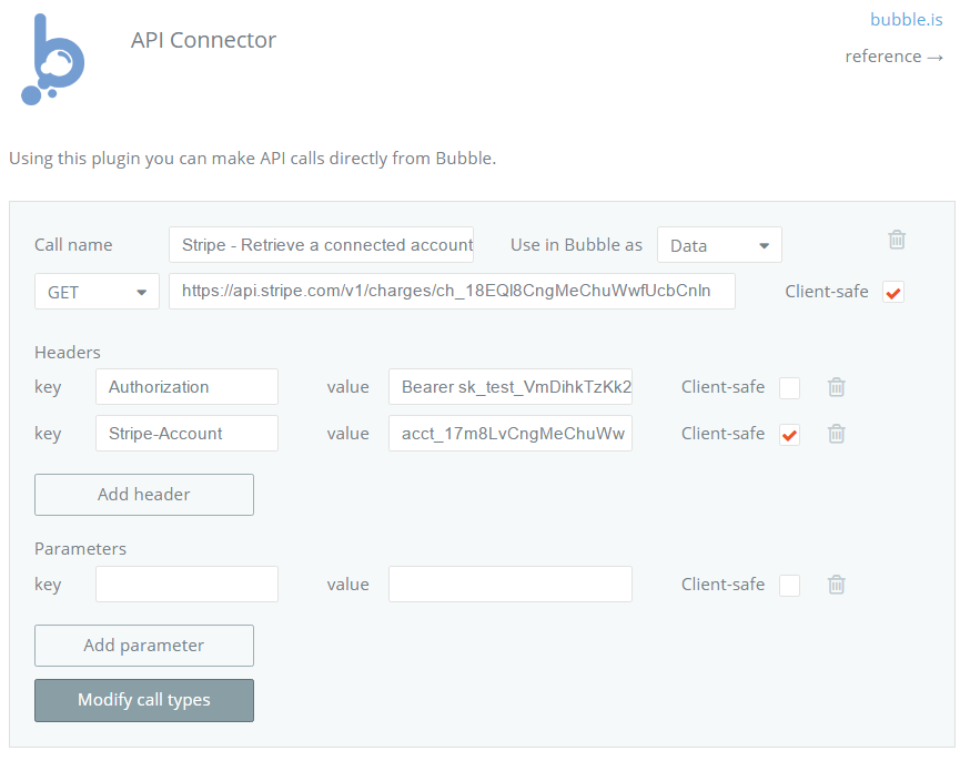

@stephencharles @ben with the API connector, it’s now very easy to integrate more in depth Stripe. First, you have to well understand the difference between events happening on your Stripe account and the ones happening on your sellers’ accounts, then copy the API call from the documentation, specifying the right parameters.
Exemple for getting info about a connected account (see the Stripe-Account header parameter to make a call on behalf on your seller) :
The result data will give you access to the parameters I wrote in my first post.
