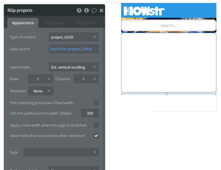

I’m working at 320px wide and telling it to stretch and add more columns if the screen gets bigger. But it’s not doing that.
In fact it says the repeating group is already at its maximum width.
This is how the element parameters are set up
Is the parent group restricting the width of the repeating group?

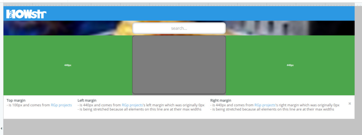

Actually I just tried grouping the repeating group, so that it does have a parent group. The group stretches to the same width as the page, but the repeating group stays the same fixed width.
@emmanuel Is this a bug? I’ve found that the repeating group fails to stretch when it doesn’t have a border. If I change nothing else except changing “border style” from “none” to “solid” all of a sudden the repeating group stretches and adds columns like it’s supposed to.
It’s happening here http://howstr.com/version-test/stretch_test?debug_mode=true

After playing around in a bit (in a cloned page), the minimum cell width was preventing the repeating group from behaving responsively. Changing it from 320 to 100 resolved the issue.
Huh…yeah that parameter does seem to control whether or not it adds columns when it stretches. Maybe the border is just invisibly changing the width by 1 or 2 pixels, accomplishing the same thing?
So as long as “cell min width” is less than 320 (in this case) then multiple columns appear when the repeating group is stretched. 320, or 321, or 400, result in only one column even when stretched.
That doesn’t seem like the correct behavior, does it? @emmanuel
When the page is responsive, specify the smallest width the cells can have when the page is resized. When the page becomes too narrow for all the cells to have that width, the repeating group displays fewer cells per row.
The cell min width has to be lower than the element’s width for this to work. We’ll update the reference, we shouldn’t even allow users to do this…
