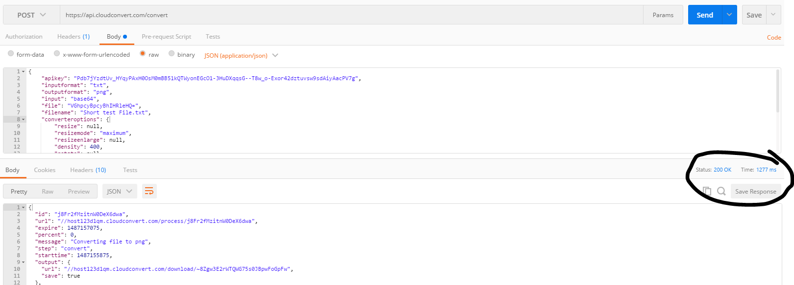

Here’s the first call to get the conversion token/URL you need:
One of the things it will return is a unique URL which is what you need to call next to start the conversion:
So in your workflow, take the returned URL and feed it into this next call as the ‘hosturl’
‘file’ should be the URL of the page you need to convert to PDF
‘callback’ is the endpoint CC will ping once the conversion is completed/failed
‘save’ - yes if you want to save file to CC account, otherwise, you need to download immediately
‘wait’ - can’t remember exactly, but it didn’t work if this wasn’t set to true
Finally, once the conversion is complete, CC will ping that callback endpoint with some other data, and most importantly, a direct download link to the file.
I never got round to it, but I guess you could create an API workflow that captures that direct download link and does something with it. What I do know is that the download link is only active for about 24 hours, so best grab it and save it somewhere.
Hope that helps!
