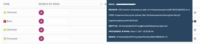

Hi there,
I´m having issues with Sendgrid since sometimes I get a “block” in the activity feed so the email is not sent.
Does anyone know how to solve this?
Thanks a lot.
