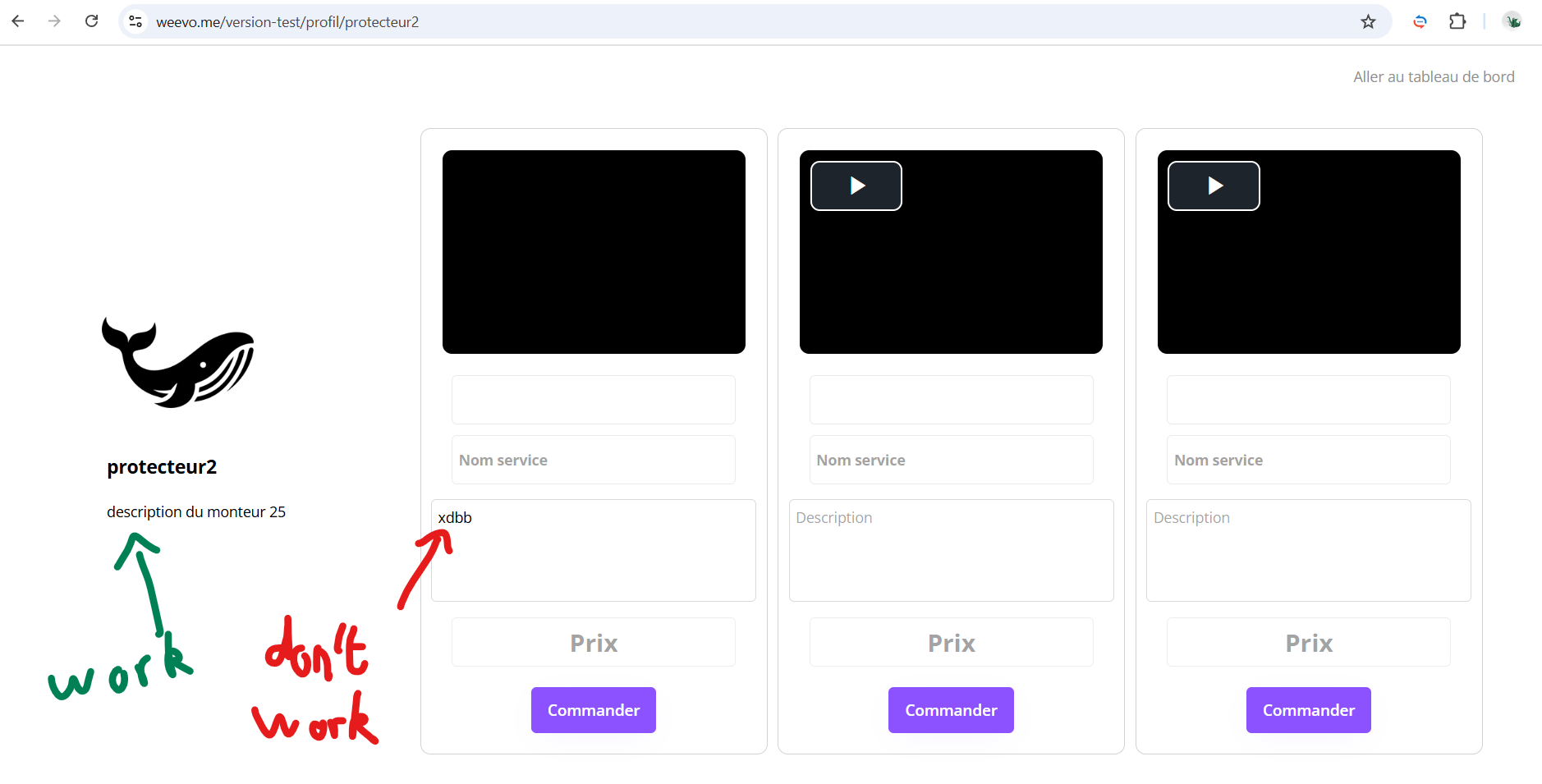

I try to set auto binding to the profile page (type user), so the connected video editor can edit the service template and it automatically save.

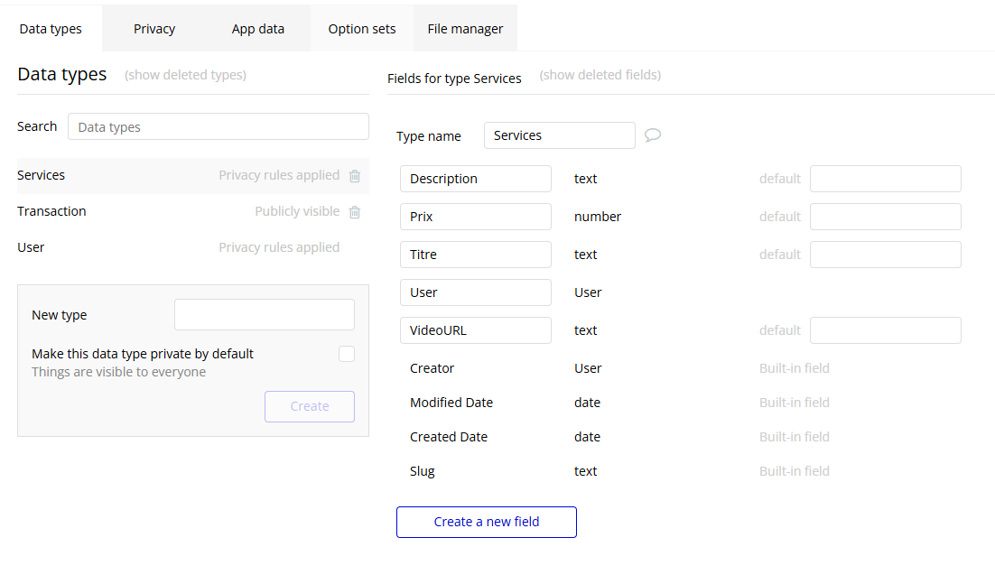

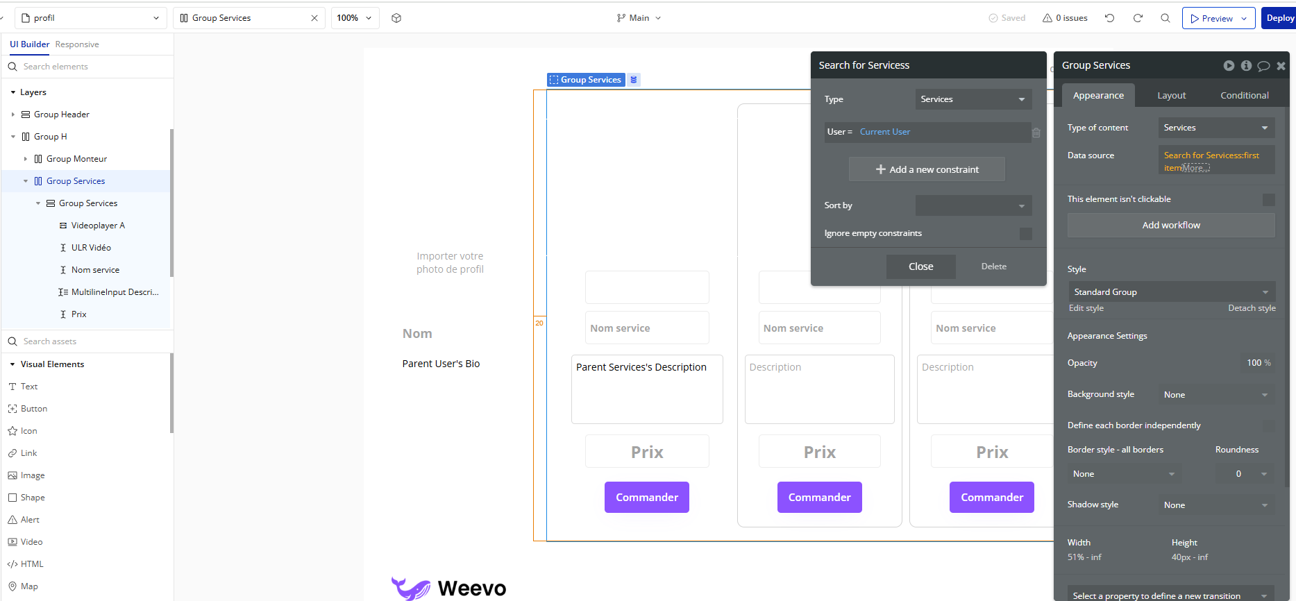

I have two section : user info (type user) and services (type services). It work on user section but not on services section. Can auto binding work on both in the same page ?

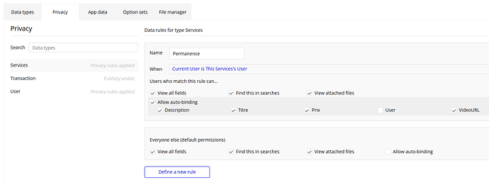

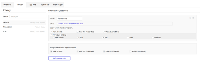

Yes It should work. Have you checked your privacy rules? Most of the problems with autobiding are usually related to privacy rules settings.
Yes, auto-binding can work on both user and services on the same page, but you need to check a few things. Make sure privacy rules allow auto-binding for both data types. If your page is set to user, but you’re trying to auto-bind on services, you may need to use a group with “Services” as its data type. Also, if services is linked to user, ensure the correct service entry is referenced. If it’s still not working, try loading services in a separate group with a proper data source. Hope it helps!
Yes all is set up…
Hello, thanks for your help ! privacy rules are ok and there is a specific group for services with data type services…I’ve tried everything i guess…
Would you mind opening the editor on view mode? If you prefer send me the link on a private message, so I can delve deeper on the problem. Just the screens dont tell me much of what could possibly be happening.
can’t send you a private message beacause i just joined the forum, and I have starter plan so can’t activate the collaboration, would this link be usefull ? Weevo
