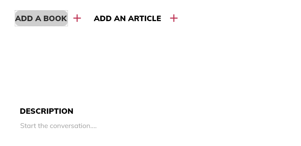

I had set up a tagging system. Here, when ‘add a book’ is clicked, it shows the ‘hidden search (toggled element)’. When the user types name of book and clicks on ‘add’ the book gets shown.
Below that is a small description option to describe.
But when i preview it, there is a huge space between button ‘add a book’ and ‘description’ input. I am not able to figure out why is that big space showing.
the repeating group and the search option are ‘visible on page load’, but the group containing them isn’t and is set to ‘collapse when hidden’. It shows up only when the button ‘add a book’ is clicked so that the whole group gets toggled.

need to put the elements that are hidden in a group that will be hidden and select collapse height when hidden.

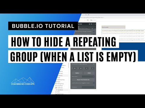

Got the solution to this with this video by @romanmg! Thanks for making this tutorial
Yeah that is the way to do it…put the elements in a group that will be hidden and select collapse height when hidden. Then put a conditional on the element to hide when you want it to.
Remember that trick, it comes in handy for a lot of things, not just R.G.
Only thing is you need to think of the conditions to set for when it should be hidden.
I use this mostly on forms to set up multiple step forms.
