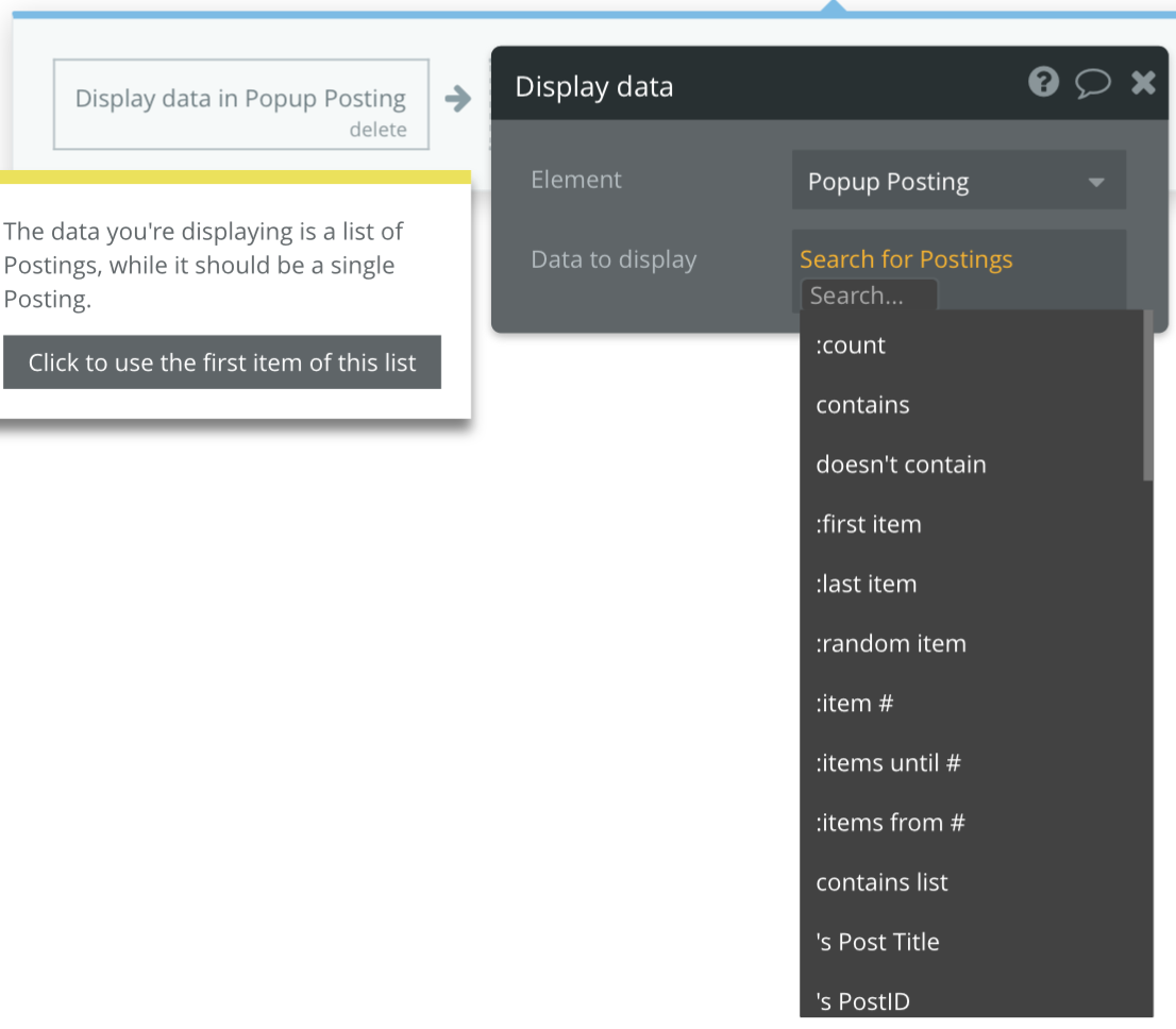

Now though, I can’t find an open that allows me to display the current cell’s data in the popup group.
Therein lies the root of the problem!
Any ideas? I tried “doing a search for” postings (that’s what I’m trying to display, a job posting) and that doesn’t lead me somewhere I recognize what to do.
-Kian
Hey Kian :slight_smile: The button would need to be inside of the repeating group cell (in order to reference it). So the workflow could be:
“When Button View Post [for example] is clicked”:
1st action: Element Actions --> Display Data --> Element: Popup Posting, Data to display: Current cell’s data
2nd action: Element Actions --> Show Popup Posting

Hi there!
Exact same problem and the solution is here.
Can’t finalize it though on the last step, any idea why?
  • My popup has the same type than the repeating group
  • the icon is well inside the repeating group
Here is the event when we click on the icon that opens the popup:
Don’t understand why it does not allow me to end this with “Curent’s cell’s Trip’s itinerary_googlemaps_embed_value” with 's value
Apparently it wants something else.
The itinerary_googlemaps_embed_value is just a string of text, it will be used in my popup on this:
The data you should send is current cell’s Trip. Then, the HTML map code you put there should work fine.

Sorry, I wasn’t clear enough in my explanation. My bad!
In the “Display Data” image you had before, the data to display should just be “Current Cell’s Trip.”
Oooh!
So simple, indeed it works, many thanks Andrew :slight_smile:
Hooray!
In general, you just need to supply the high level “Thing” when you pass data, then access the varying fields of the Thing through the context menu of the element inside the group or popup.
