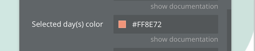

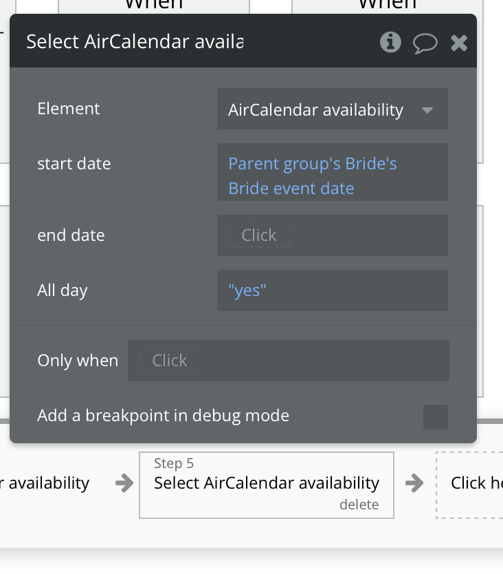

Hi @ZeroqodeSupport, please could you let me know what I’m doing wrong with the ‘selected date’ colour. I’ve set the workflow to select the date and set the colour but it’s showing a light blue shade instead.
Screenshot 2024-05-13 at 13.34.34

Indeed there seems to be an issue with the Selected date’ color field you mentioned and have already forwarded it to our development team for further analysis and resolution.
In the meantime, here’s a simple workaround that you can implement to keep things moving:
Please add a small HTML element to your page—ideally 1x1 in size so it won’t interfere with your app’s layout. Then, insert the following code into the HTML element:
<style>
.fc .fc-highlight {
   background-color: #FFE100 !important;
</style>
Replace #FFE100 with your preferred color, also you can use dynamic data there as well. Could you please try this in your app and let us know the results? If you need further assistance or have additional questions, do not hesitate to contact us.

Awesome thanks :pray:
