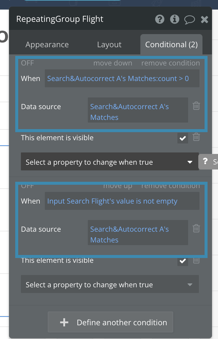

Hello, everyone.
Let us please provide a short guide on how to use the 14th version flawlessly :smiley:

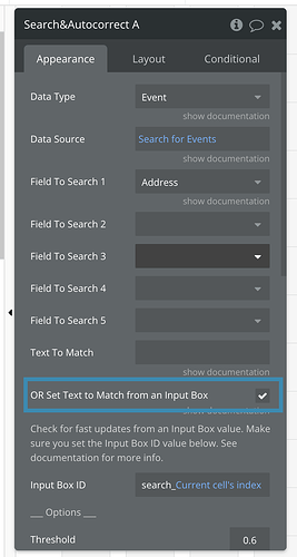

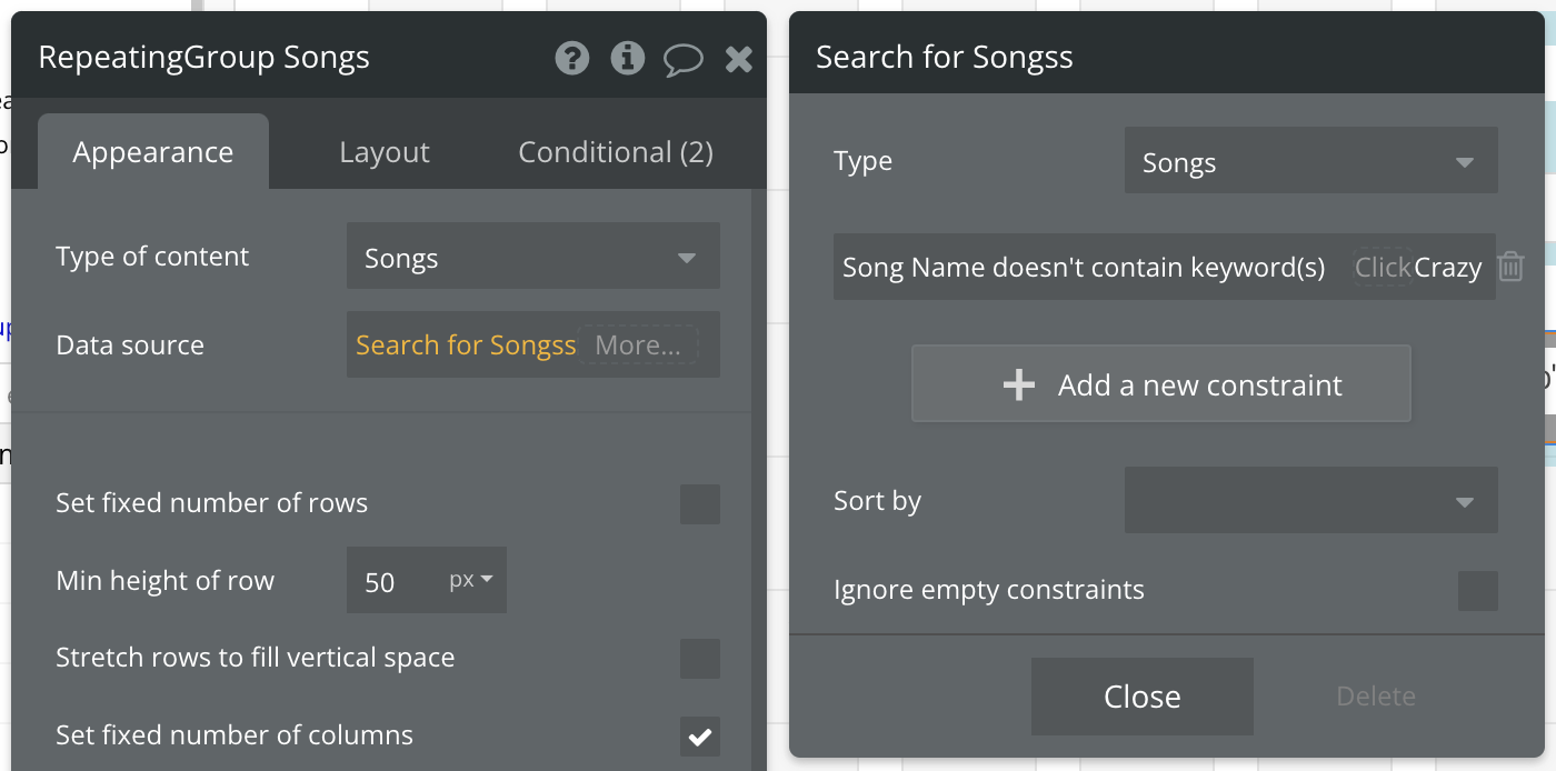

  1. if you use the static search ID , you might need to make sure you have these 2 conditions on your Repeating group with results:
    In some use cases, disabeling of this checkbox might help:

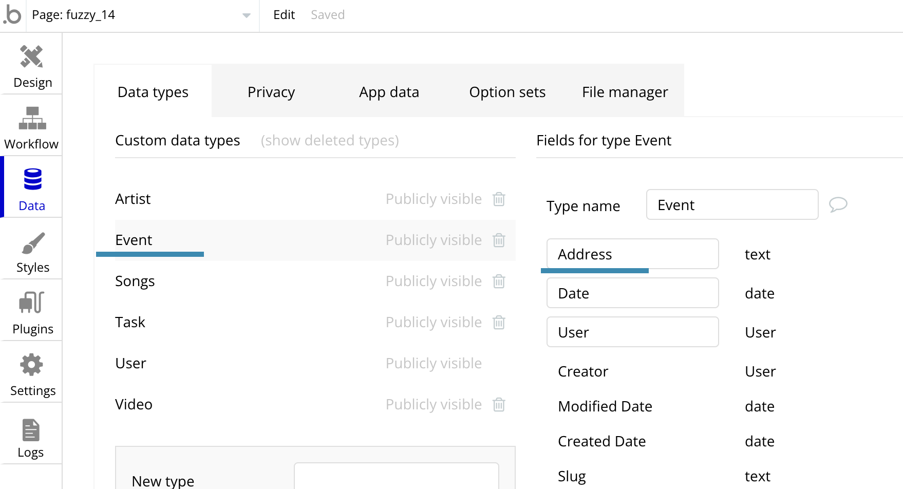

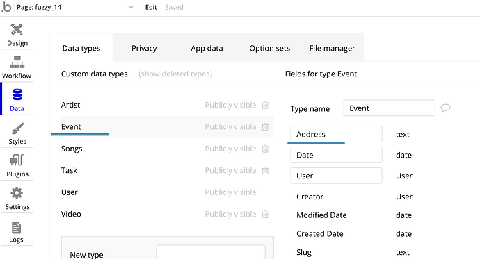

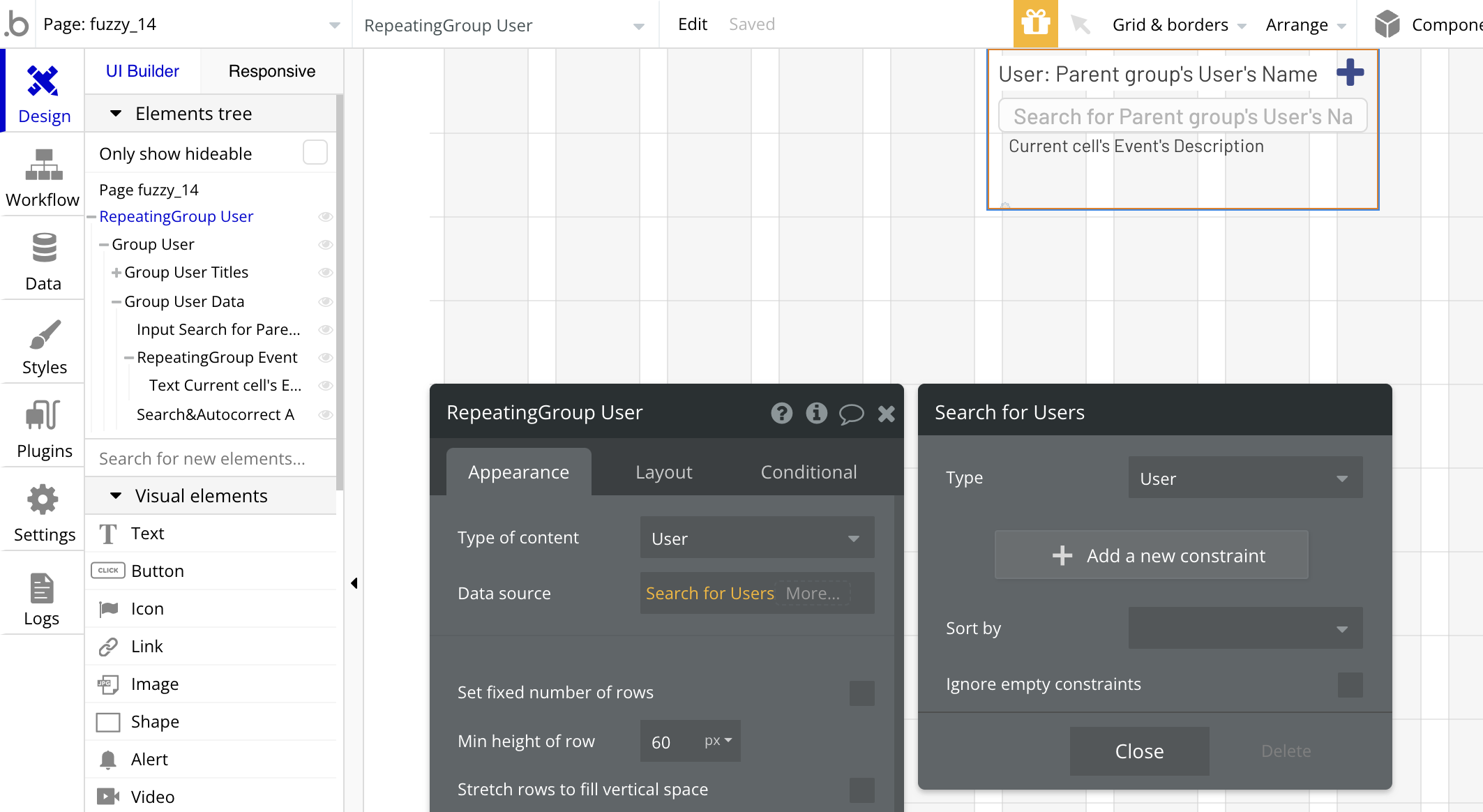

  2. if you use the dynamic search ID , here is a test app with the functional 14th version.
    The use case: each user has a name, email and Event. Event is a list of other parameters such as date, description, and user. There is a Repeating group that shows the list of users. Inside each “user” cell - there is a list of this user’s Events. You can do a search on each user’s event list.The setup is super simple:
Summary
How it works:
Friends, please feel free to DM your use case setup in case you need some help or verification from our side. We confirm that with the correct setup 14th version is functional. :smiling_face_with_tear:
Regards,
Zeroqode Support Team

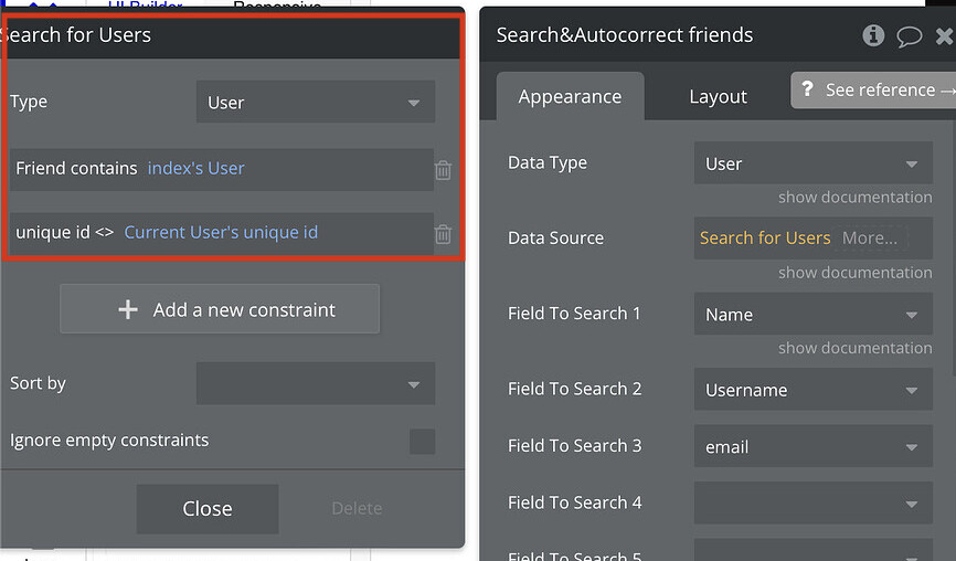

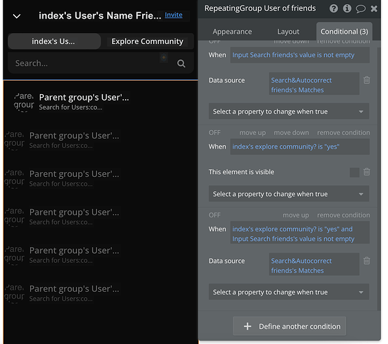

We have created an element where the user can search between their friends or they can search throughout the whole community and we are using the fuzzy search element. The search bar is not even responding when we type in a name to search up in neither the explore community repeating group nor the friends repeating group. We do not know the problem.
Hello, @wyatt.10. Thanks for reaching out and using our plugin :pray:

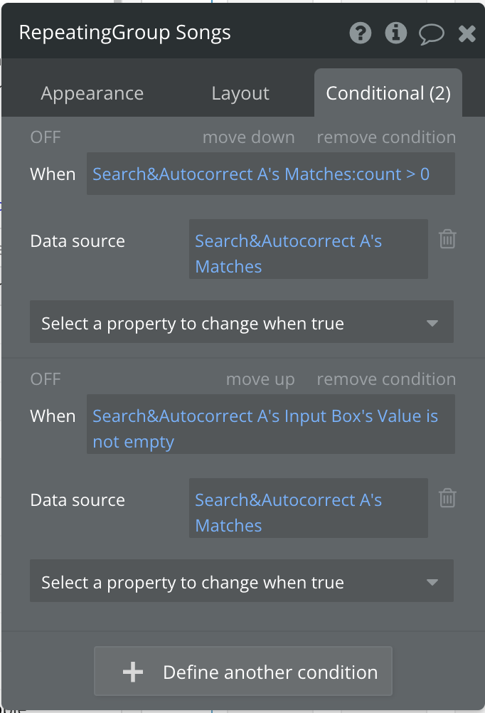

If you are using the latest plugin version, please:
  1. use the recommended on the plugin demo page setup for the Repeating group (Conditional tab):
  2. do not apply any filters or constraints to the Search&Autocorrect element
If you want a filtered search result, apply filters after the plugin has returned you the list of Matches. You can do it by adding this filtration method to the Matches results:
or set your filter right into the Repeating Group:
Hope it helps.
