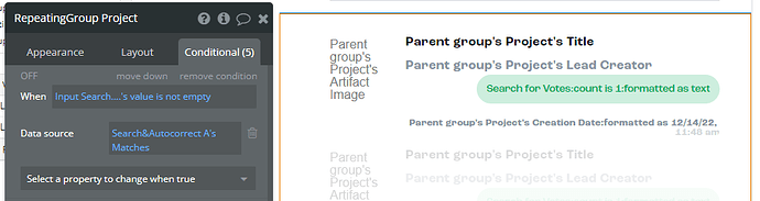

As we can see, you have a lot of conditions for your RG and input. Please make sure that you don’t have conditions that contradict displaying all the data.
Also, you need to add the “Show Search&Autocorrect” action on the page load. It’s because the input element you are using to search is loaded before Search&Autocorrect.

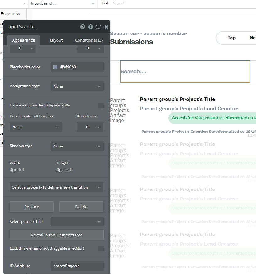

Hi @macyhong7 @daviddr17,
Thank you for your messages.
Can you please share screenshots of your setup, the plugin element, the input you are using, and the ID Attribute set?

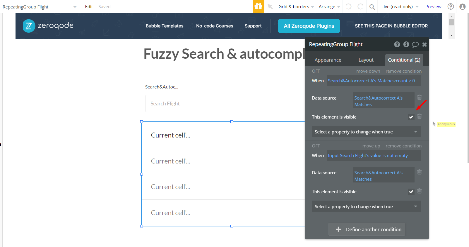

Also, please check the conditionals of your Repeating Group showing search results and compare it with the Screenshot below:
Please try adding the same conditional and let us know if that will solve the issue with the Fuzzy Search plugin. For additional setup guidance, please check the plugin demo editor page:

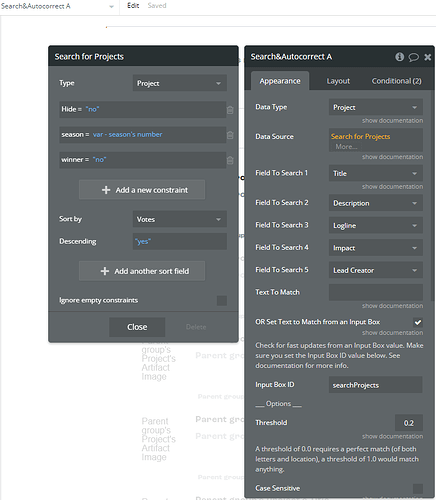

I was having the same issue! But managed to solve it :smiley:
Uncheck the box that says or set text to match from input box. Instead, make a dynamic link with the input through the “text to match” (as per my photo). This fixed it for me at least :slight_smile:
@ZeroqodeSupport Looks like the latest version of your search and autocomplete plugin broke the functionality that references an input by it’s id. If you have that option enabled, it never returns any matches even if matches exist in the database. If I leave the settings the exact same and rollback one version, it all starts working again. If I uncheck fast updates using id and instead dynamically reference the input’s value, that also works, but is noticeably slower as expected.
