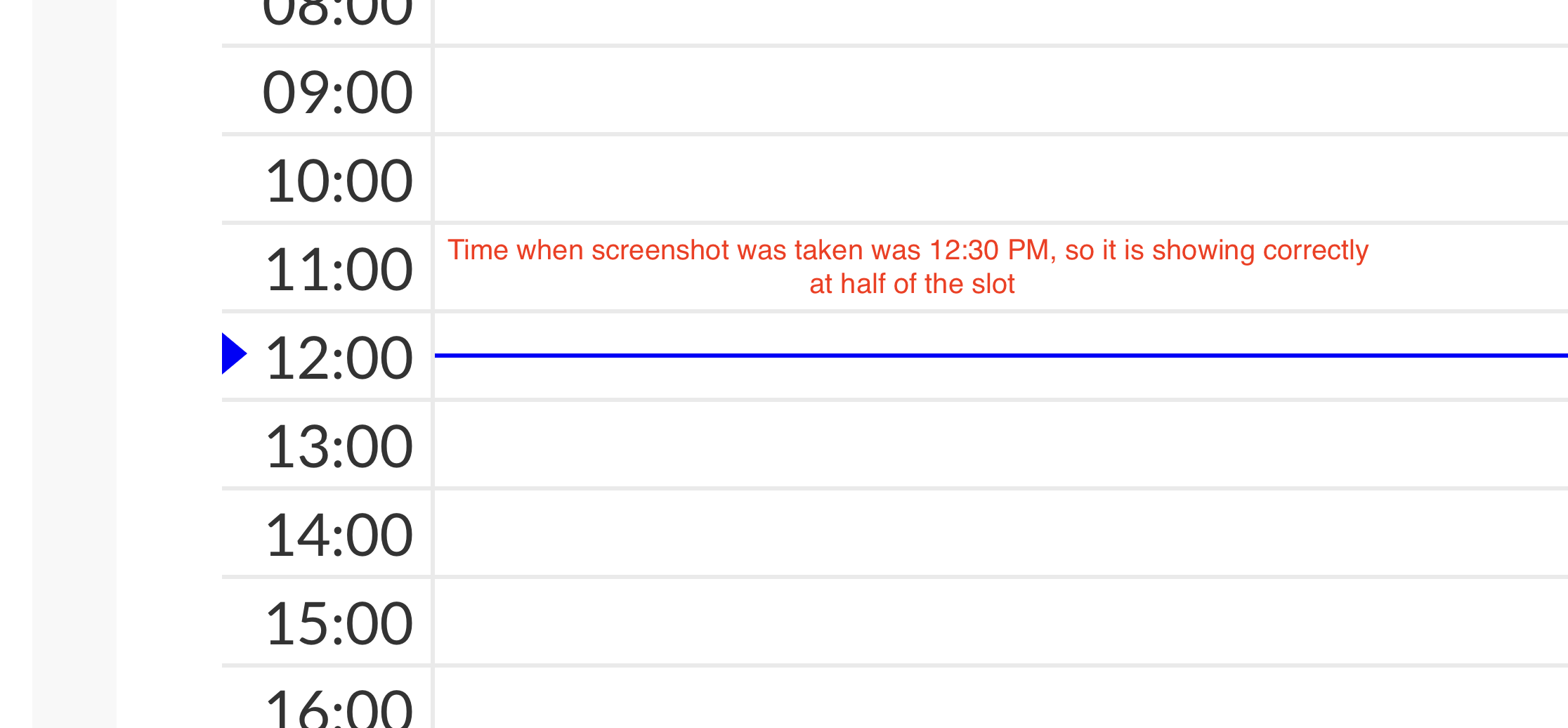

Hi, see this screen shot to understand. Unfortunately i havent had a chance to open up the editor and show the error but i can explain it from this.
When both the slot step and time description step are set to 60 the indicator only shows the hour and not the relative time like this screenshot. Its currently 630am. See how the indicator is properly tracking the time in this image. When both steps are set to 60 the indicator would be staying at 6am not showing 630am
As soon as i set the slot step to 30 it begins tracking time properly again

Hello @jacob2,
Thanks for providing further details.
Upon configuring both the âSlot Durationâ and âSlot Label Intervalâ to 60 minutes, the calendar is designed to display hourly slots with a single slot separating each hour. On our side the time indicator is showing the correct relative time, meaning if itâs 12 it will be at the beginning and when itâs 12:30 it will be at half between the 12 and 13 timeframes.
If you are getting different results, kindly provide further information such as the settings for the Air Calendar element and a video demonstrating the calendarâs behavior, including any discrepancies or errors you encounter. Additionally, we invite you to visit our test page, where weâve applied the same 60-minute settings, to compare its functionality with that of your application.

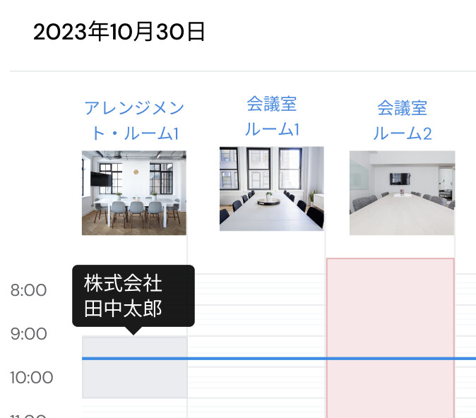

Thank you @ZeroqodeSupport , one suggestion too. Weâve one requirement to render resources from database. We need to display images too. Can you provide the feature or let us know if you have this in enhancement? Please refer to the screenshot below:

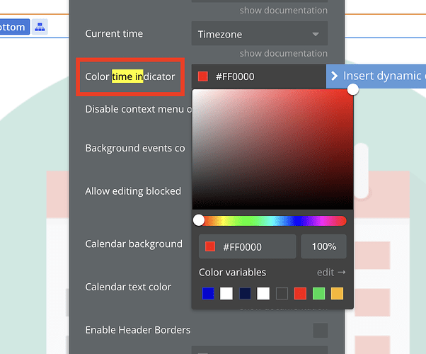

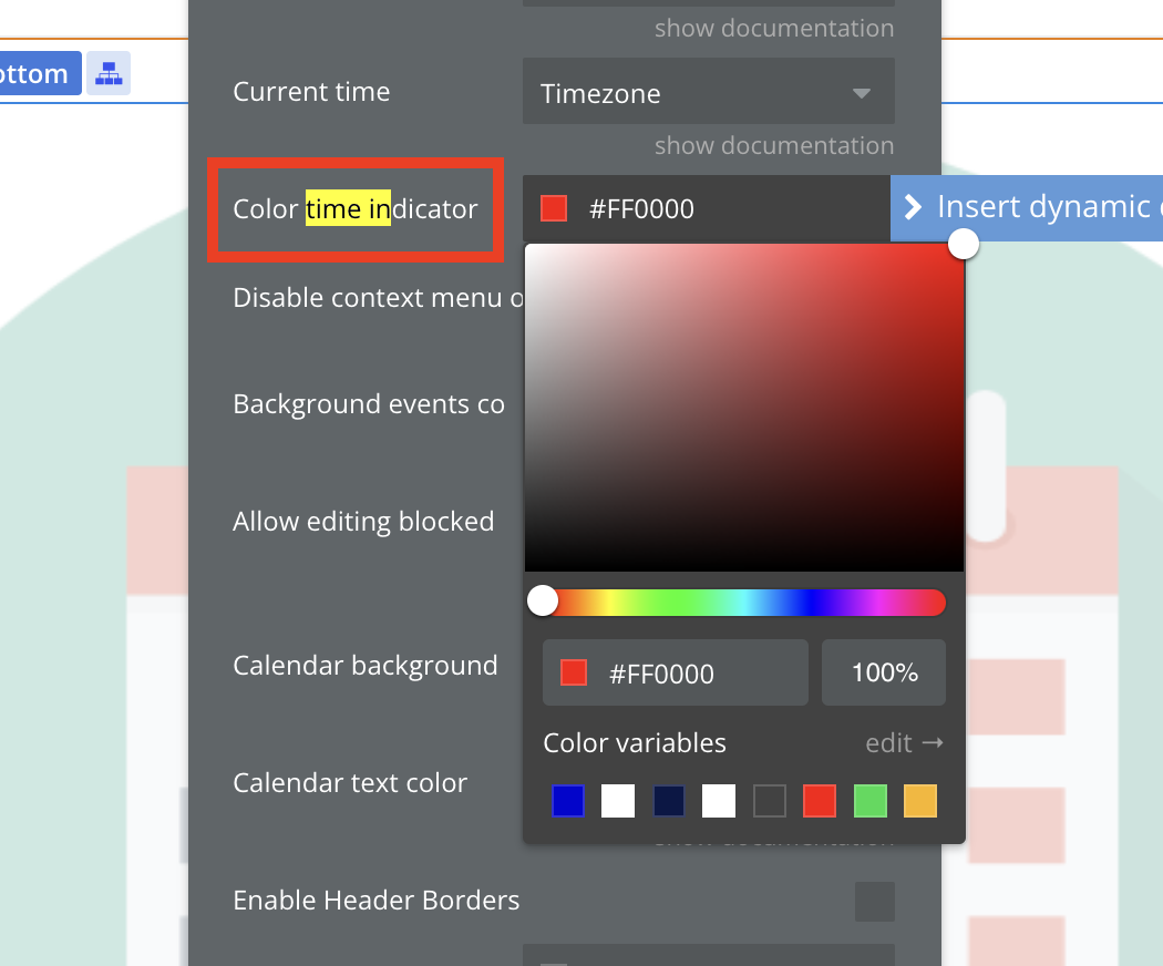

Hello @jacob2,
We hope this message finds you well.
Weâre excited to share with you the release of version 2.82.0 of the Air Calendar plugin. In response to your feedback, weâve introduced a new feature - the âColor Time Indicatorâ label. This enhancement allows you to customize the color of the current time indicator according to your preferences. Youâll find this option in the element settings, as illustrated below:
We kindly ask you to update the plugin within your application and explore the newly added feature. Your feedback is invaluable to us, so please share any thoughts or insights you have regarding this update.
Additionally, if you have any further questions or need assistance, donât hesitate to reach out to us.
Thank you once again for your continued cooperation and patience. ![]()
Best regards,
Zeroqode Support Team
Perfect, thank you!
Hello @nocode8 ,
We hope this message reaches you in good spirits.

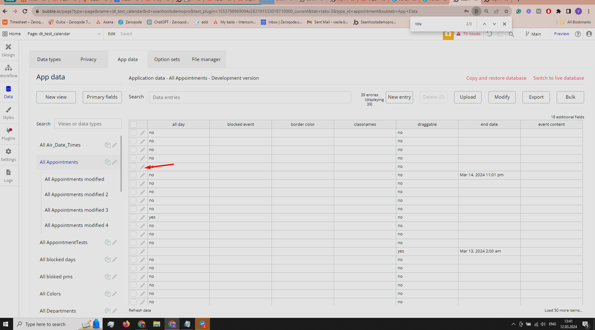

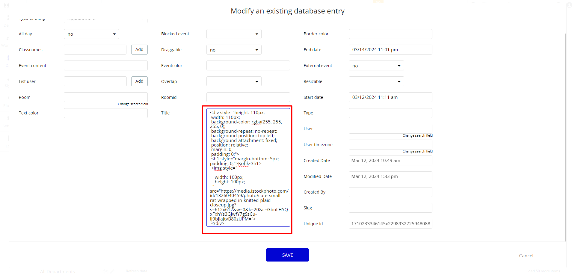

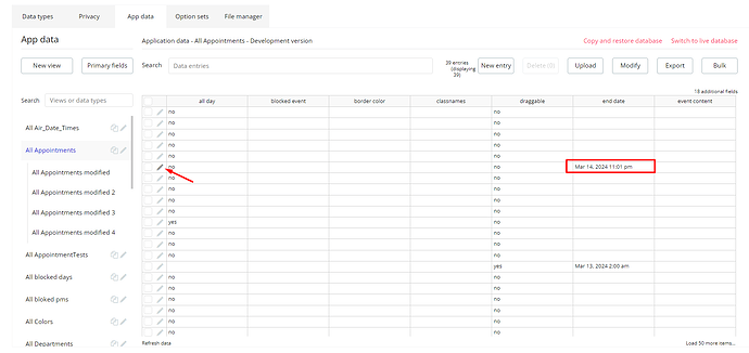

Our dev team further verified your request and found a workaround that allows you to add images to your calendar events.
The process is very simple, you just need to open Air Calendar and set this checkmark called "Title has HTML Content " :
From there you will need to open the Appointments from your App data:
Then you can press edit icon on an already existing event or create a new one and add the following code in the title, feel free to adapt it for your own app of course.
You can see that the image is added and now with the help of HTML you can customize the details according to your needs.
To get this exact HTML code please follow this link on our test page and press edit for the highlighted event.
Hope this was helpful, let us know if you have any other plugin-related questions. ![]()

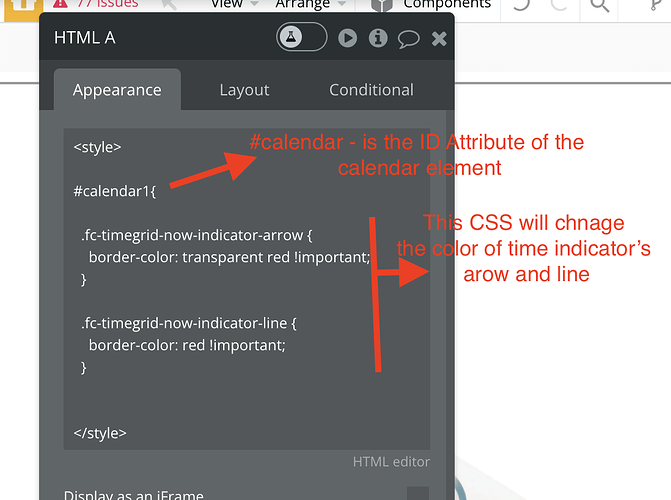

Hello @teamprogresscomplete,
Thank you for reaching out and sharing your observations with us. ![]()
Weâve conducted some tests and noticed the thing you mentioned, where one style attribute goes to the second element as well. Our development team is currently exploring solutions to address this.
Meanwhile, thereâs a workaround you can try. Begin by assigning a unique ID Attribute to each Calendar. Then, add an HTML element to your page. This will allow you to customize the style attributes for each element individually. For instance, the image below demonstrates how to modify the time indicator color for a specific calendar:
Using this method, you can adjust any style attribute for a specific Air Calendar element on your page. To identify the names of the elements you wish to modify, simply use the inspect tool in your browser and select the component in your Calendar.
Regarding your second inquiry, it pertains to the Air Date/Time Picker plugin, which offers the ability to change its style attributes. If youâre looking to achieve a unique appearance, you can apply the same strategy using the HTML element to tailor it to your preferences.
We hope you find this information useful, please let us know about your progress. ![]()
